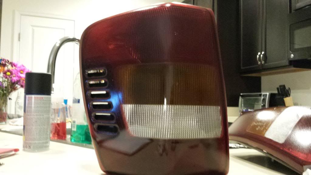

This is with 3 light coats of vht nightshade, it can be done lightly. I dont have a picture of them on the jeep cause it was raining when I did this, painted them on my patio, stuck them in the oven for about 10 minutes and they came out great. I masked off the reverse light, I know some people think its stupid but I live in a dark area and I like being able to see when Im backing up lol.

Looks good..... I say that mainly because they are almost identical to how I did mine....similar level of tint and masked off reverse light!
OP.Ignore the pics in my thread...they are not as dark as they look there....more like NOVAXJs.

This looks pretty much perfect... If you take a pic of them on the Jeep if love to see it.

After I put LED's in my reverse housings, they are very much brighter. That and my license plate bulbs are very bright white, now.
