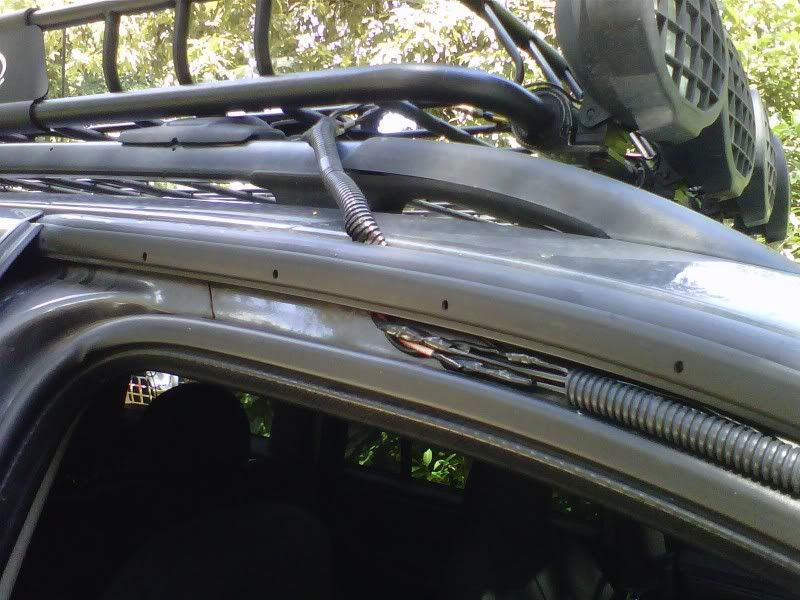

Credit to Jerzeyboy's Jeep
Hope this helps

I drilled a hole in the front part of my roof rack. On the passenger side and went down the piller on the inside of my jeep. It was easy and you can't see any wires anywhere. And I didn't have to take the headliner off. Just remove the plastic on the outside drill the hole run the wires Silicone the hole and put the plastic back. And you can't even tell
