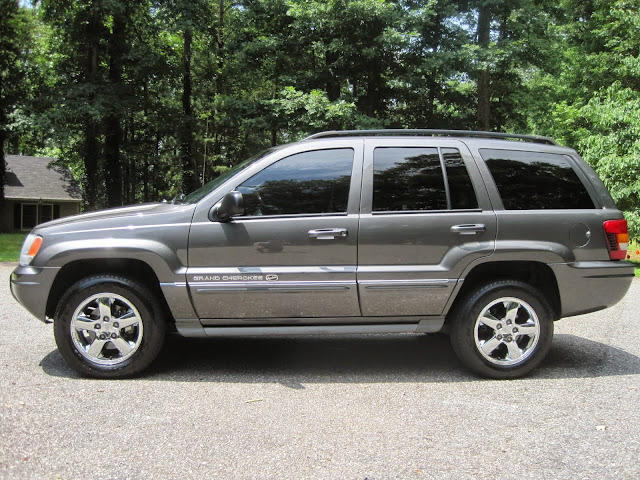

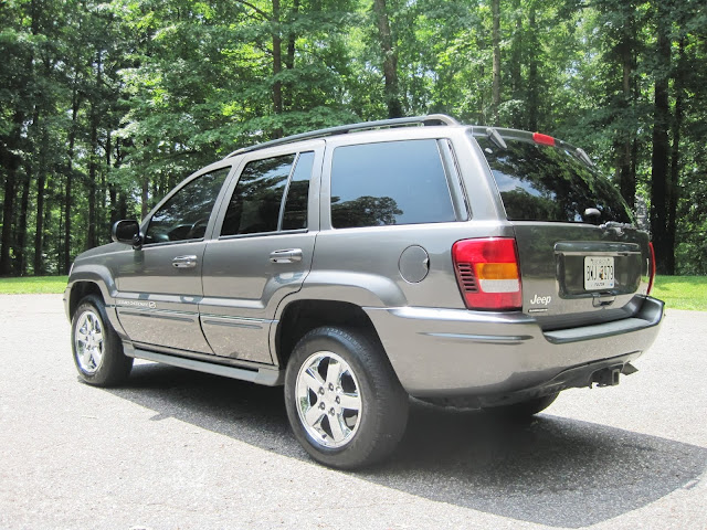

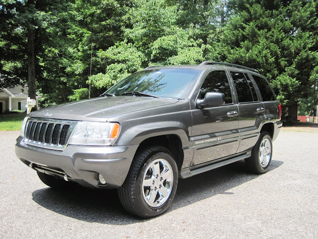

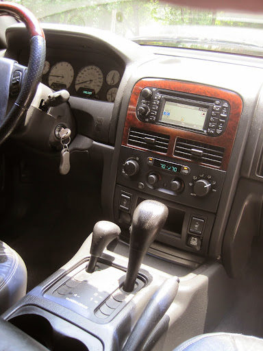

Just picked up my first Jeep! So far I've changed all of the fluids (engine, tranny, transfer case, differentials) and replaced the pinion seals front and rear. It was a lot of work but I knew about the seals before I bought it. I'm still trying to work out an A/C problem as it blows pretty warm. I took it to a mechanic who measured the high and low side pressures for me (175 high and 8 low) and told me it needed an expansion valve. Anyone have any experience with A/C and expansion valves?
Some pictures of my new ride after a good cleaning!

The RB1 is a single unit in-dash AM/FM/CD/Navigation Radio.
