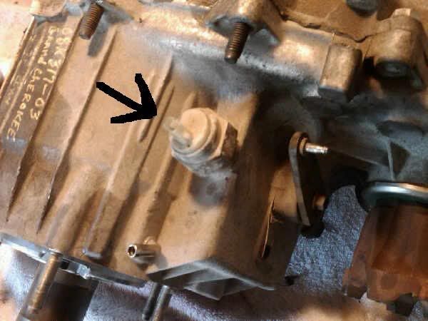

well im starting to tear my t-case down to make sure everything inside is good when i saw a connector on the 242 that im not seeing on the 247 (shown in pic) do i leave this alone? didnt see anything mentioned about it in your write up..thanks again for the help

Thats the plug for the 4wd light to come up on the dash...I didn't bother doing it on mine, you would need to buy the plug and then trace the propper wires to the transmission wire harness...more trouble thats its worth IMO. Doesn't do anything put activate the light on the dash.
