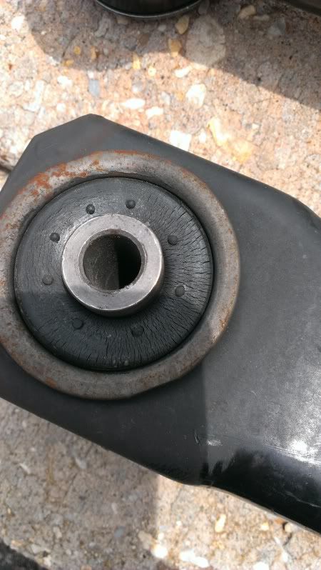

Like Skain said, I would take one out at a time to inspect. Leave the car on flat and level surface with wheels on. Remove and apply some shear stress and hope it doesn't look like mine i just replaced that are less than a year old.
