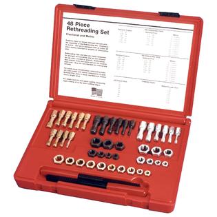

Very cool thread; thanks Arlo et al. Everything came off fine EXCEPT the hub. Ended up using the air chisel and then needed the air grinder to smooth the mating surfaces down. Another issue was the Ebay part was too long...thank God for the local Auto part store.
Slathered surfaces with anti sieze and took time to clean the bolts and threads using this>>>
She turns butter smooth now =)
