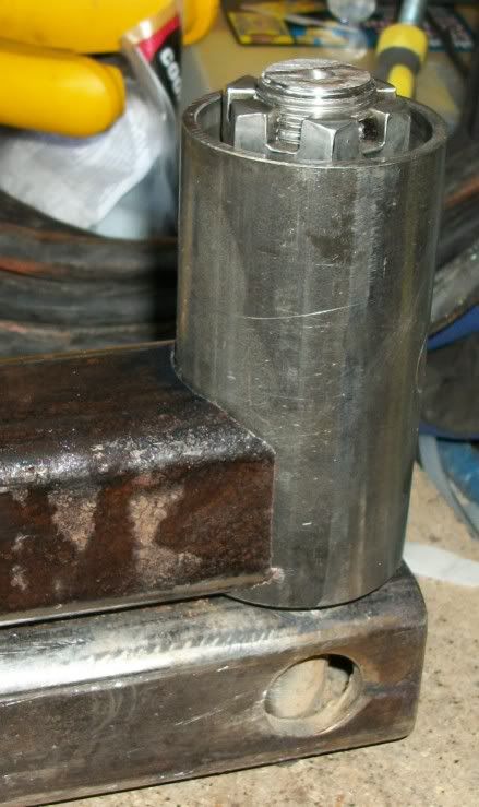

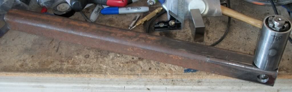

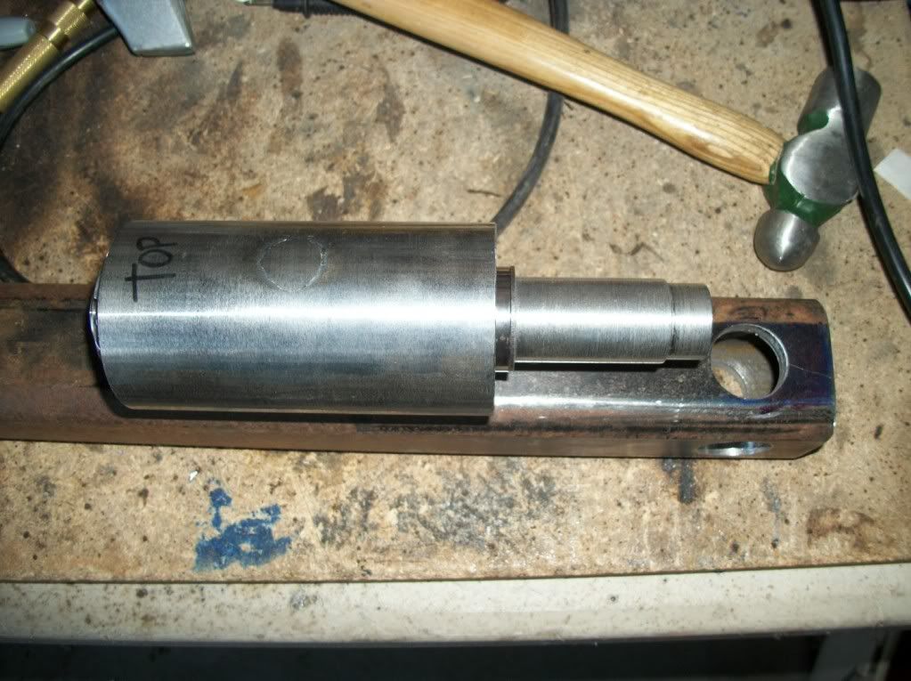

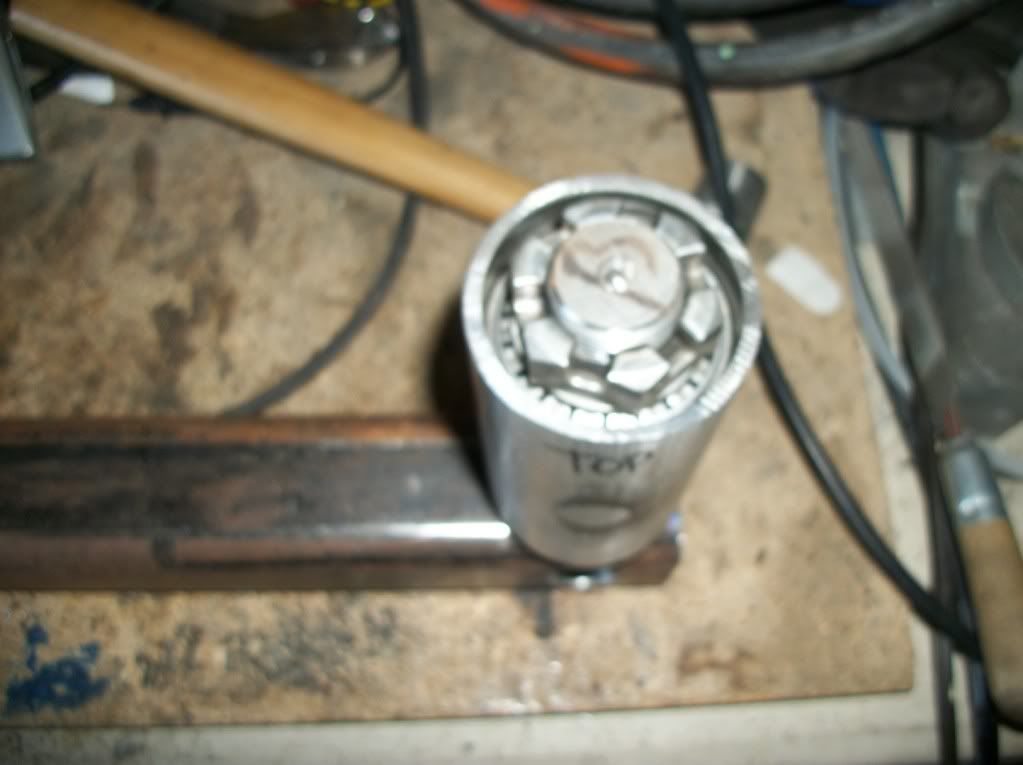

This time I'm doing it right. I'm using 2" heavy wall tubing and an pivot axle made by Kro Built.
Here's the start.
Bottom tube that gets welded to the receiver with the axle sitting in place. You can see the dust cap in the plastic bag above the tube.
The axle and shaft. I machined the shaft to 1.00" and relieved the bottom to 7/8 so I can wiggle it perfectly straight and perpendicular and then tack it in place. It will protrude about 1/4 inch below the tube for a great weld.
Close up of the nut and the bearings. Just regular tapered roller bearings...sorry about the fuzzy pic.

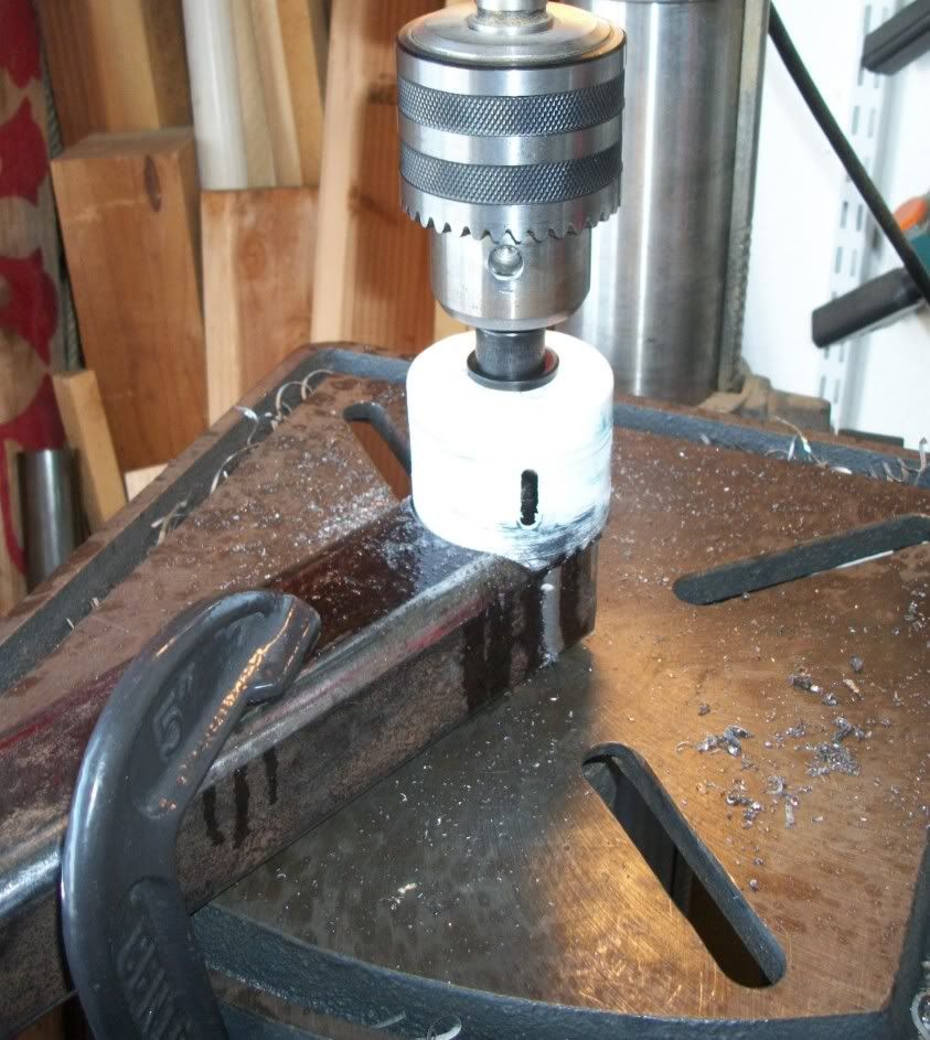

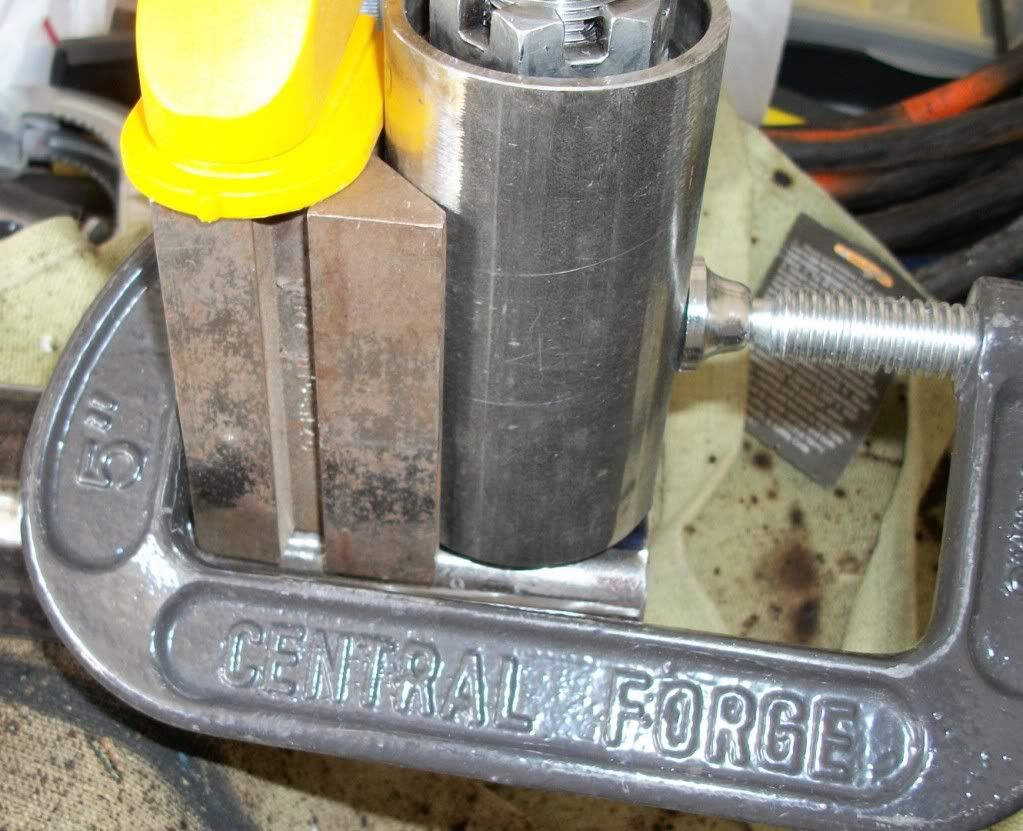

I don't mean to hijack your thread so if you want me to stop posting about my carrier I will.
Here's my setup to weld the pivot pin in place...god I love V blocks.
Cutting the 1-1/8" radius with an inexpensive Lennox 2-1/4" bi metal hole saw. It made short work of the 1/4" wall tubing. Very pleased.
