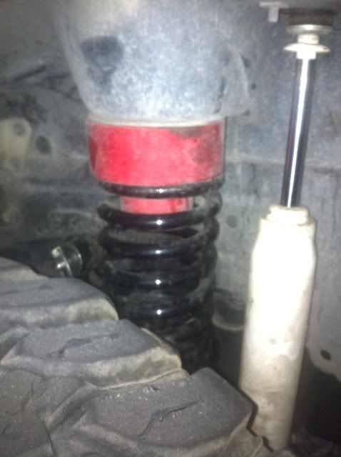

So frustrating - I bought one of these in 2009 and had a local shop install it.
I asked the guy at Rusty's if using full length coils instead of the spacers I have would help the ride.
He said they have NEVER sold kits with spacers. So why do I have spacers?
wtf???

Have you measured the actual gain you got from the lift after install? Is it still 4.5"?

Previous owner had a BB on it?

Im stumped then. No company sells pucks with a spring lift kit. Why not just send 2" longer springs? Anyhoo, like the other guy mentioned, measure from center of hub to bottom of fender (assuming you havent trimmed the bottom of your fender) You should have ~22.5" in the front. If you are closer to 25, perhaps the shop who installed it just had some pucks laying around and through them in?
Yes, it measures 22.5" from the center of the hub to the fender. I'm stumped too.

Wow hmm. Did you go through the kit at all before it was installed? I mean, theres the slightest possibility they had some lazy kid in the warehouse packing orders. Came across yours and couldn't find the 4.5" springs so he just boxed up 2.5" springs and some pucks to make it 4.5". Lucky him it wasn't someone who was going to install the lift themselves. I would be beyond pissed if I opened up my 4.5" lift and found 2.5" springs and a BB.

Unfortunately no - I chose the kit because i'd seen an episode of Trucks where they lifted a WJ with a Rusty's kit. I just ordered what I saw on the show, took the boxes to the local guy (who I've used for many things over the years - no chance anything funny went on there).
Having learned much more I'll upgrade to a long arm kit and eventually get the right springs - but it sure won't be from Rusty's. I hate attitude like that.

Did you tell the person you spoke to at Rustys that you got spacers with the lift kid instead of springs? Maybe just a mistake
Sent him the picture above along with a copy of the invoice - his response was "No sir, we sell no spacers with our kits" - in other words, I'm deluded and he's right.
Why, if I got the proper springs, would I have gone out and bought a set of shorter springs and spacers?

Thing is, I sent him a copy of the invoice and shipping order, they know I bought it and never returned it. I sent a picture of my jeep with a 2" spacer and a 2 1/2" over coil spring. There's really only one way I would have logically wound up with that setup from them. I don't think it would have killed them to offer to swap the coils and spacers for the correct springs, especially if I were offering to buy the long arm upgrade at the same time. That would seem to simply be good business sense, seeing how many alternatives there are out there.
