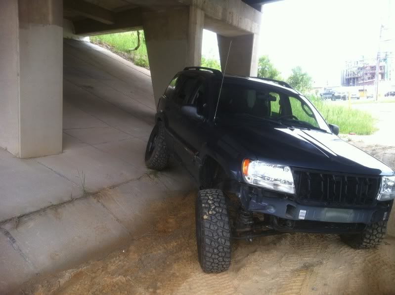

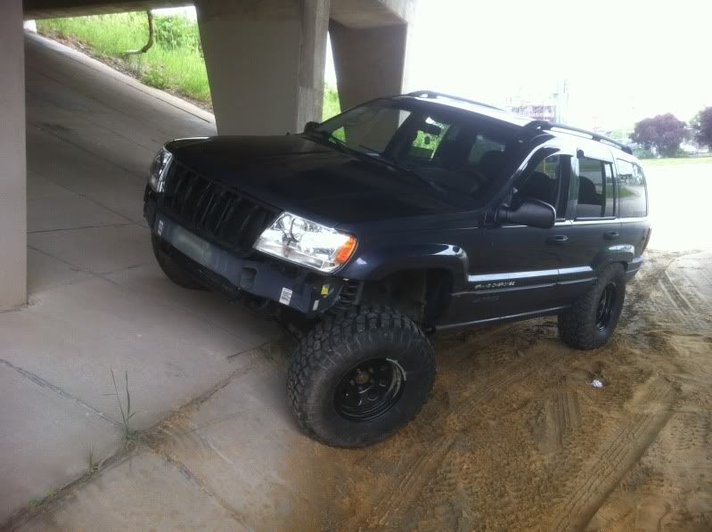

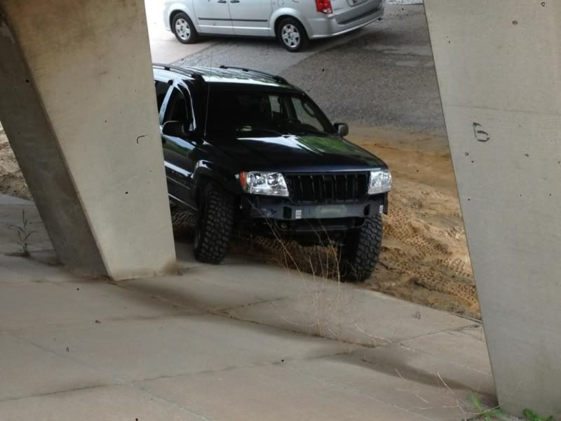

Well here is some pics after a few months of beating on it

Killallblue- What size tires do you run? It looks like they hit the front under full stuff.
