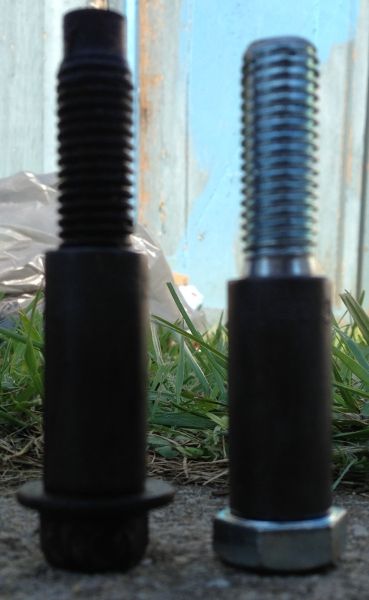

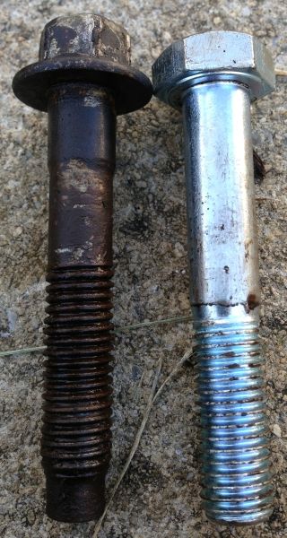

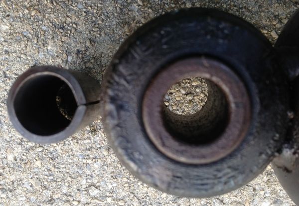

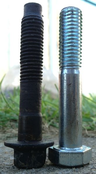

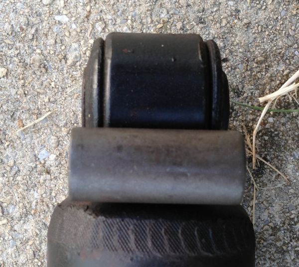

OK...needing help again. Replacing the rear control arm and the ball joint did squat to address the rattle problem. So, I bought one of those bolt/sleeve kits from Kevin's Off-road. Today I pulled the shocks out and started to compare things. I also had my wife drive the WJ around the block to tell me if she still heard the rattle. Nope, just some squeaking from the rear shocks being out. Cool, sounds like the shocks are the issue. As I said, I started looking at the shocks and it doesn't seem to me that replacing the sleeve in the shocks with the one from Kevin's kit. Looks to me like Kevin's sleeve will leave a lot of gap in the shock bushing. Hope someone can make sense of the pics...maybe I don't understand things correctly.
Here's the KOR sleeve laying on top of the bottom side of the shock. Looks about the same width:
Here it is standing next to the shock. The OD of the KOR sleeve is definitely smaller than the one currently in the shock while the ID looks to be about the same.
Here's the KOR bolt next to what I believe is an OEM bolt:
Here's the KOR bolt standing next to what I believe is an OEM bolt:
Here they are standing with a KOR sleeve on each:

The problem comes from the slight taper on the factory bolts. It gives the shock a little wiggle room. I would just try the new bolts nice and right. That's what fixed mine.

Put the bolts in today...and it looks like the rattle is gone! Thank God! Now to figure why I'm getting a whine from the right front wheel (more so when turning in one direction than the other)
