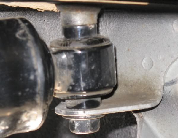

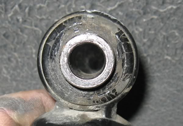

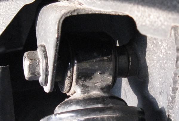

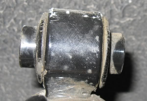

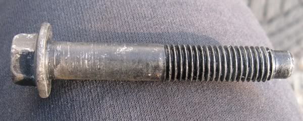

Changed the oil the other day and figured I'd pull a rear wheel to check it out. Bottom bolts look good and tight with the bracket pulled up on each side of the shock knuckle. Top, however, I'm not sure. It looks like the bushing is taking up the slack. Have a look at the pics.
Pulled the top bolt:
Top shock knuckle:
Shock installed (I did get the torque wrench out and tighten em down to 85 ft lbs, which is 5 ft lbs over spec):

Try sandwiching washers on both sides to preload them... from what I herd it's a common problem

Mine looked much like that after a shock change. I think if they were really the culprit of the rattle, they'd look a LOT more worn.
Just based on the natural axle travel and shock mouting angle, the shock has to rotate slightly from a 2 o'clock to a 7 o'clock position as seen by the wear on yours.
If the bolt were loose enough to make a rattle as described, I think you'd see gouging on the bolt as well and perhaps some ovals forming on the sleeve.
I only suggest this because I have the same annoying knock over road imperfections and my bolts are tight. I tried the washers as well with no change.
I'm thinking upper ball joint.
And they're only a year old...would be hard to believe that they'd be trash so quickly.
the bolts weren't loose at all and I couldn't physical move the shock from side to side.
