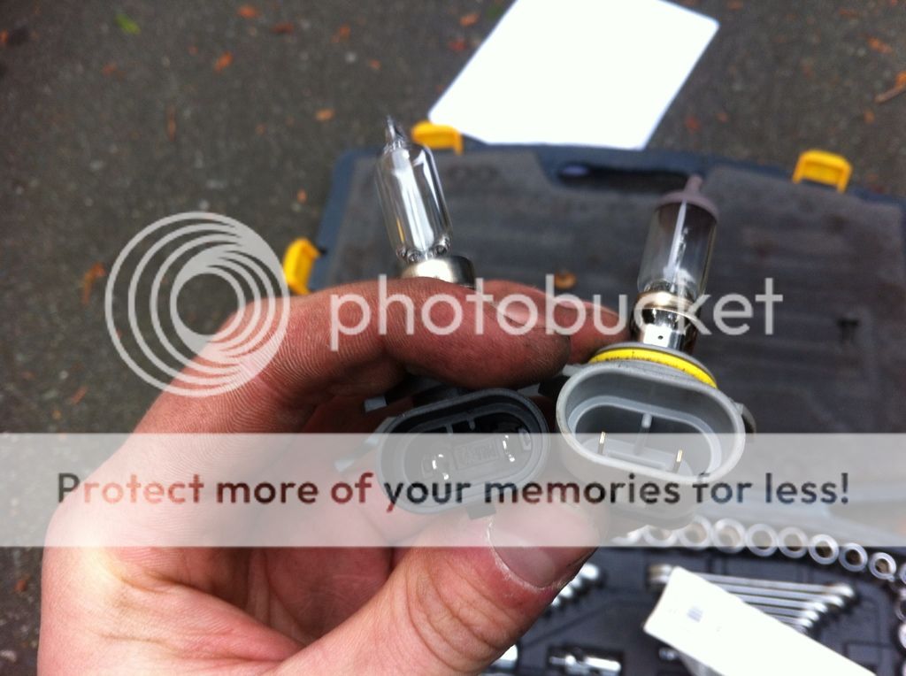

How would you modify them and are the lumens brighter on the 9012 thanks
This posts describes the install in detail:
http://www.jeepforum.com/forum/f67/w...grade-1448023/
http://store.candlepower.com/mohirbuba.html
The difference in bulb bases between highbeam and low beam is show here.
Many people have ground off or cut the posts in the highbeam bulb to allow it to connect, some have simply forced the connector on.
