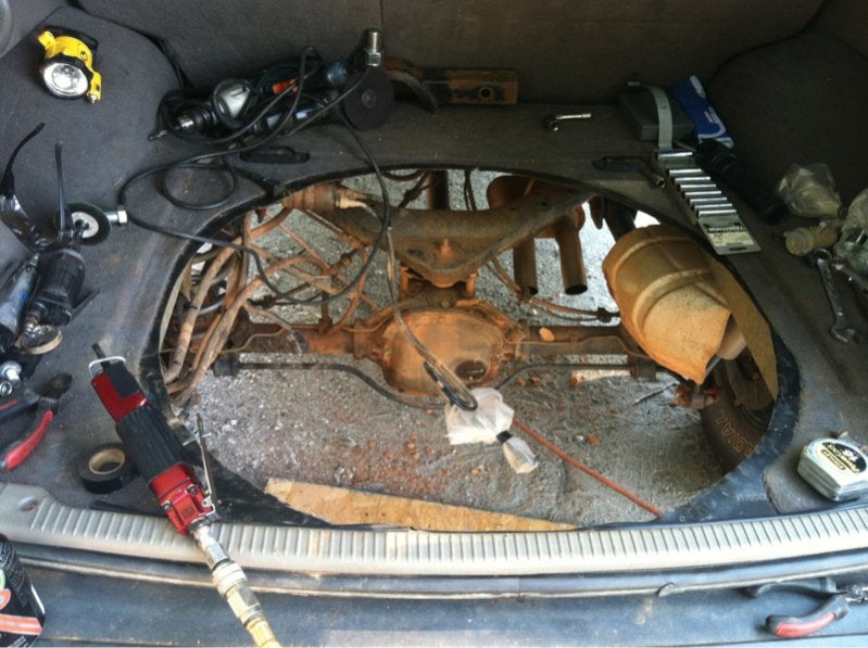

Nothing wrong with cutting it while the tanks in. There's no way to you'll reach the tank with a grinder as low as the tank sits. Stay at the top of the well and you'll miss all the lines too. Did it myself no problems as well. But I did it to do a tank tuck not to change a fuel pump lol.
I cut it out with the tank in but here's pic with the tank out sorry I don't have a pic with the tank in at factory height.
Sorry the last 2 pics have a glare because its dark with the flash on lol. I also made a door so I can easy access to all that good stuff.

I did my well removal with my air nibbler..worked great...

Adding to this thread cuz I recently did mine.. Tried dropping the tank and gave up after hours of difficulty - seized bolts, etc... Used photos on this forum to locate areas to cut through spare tire well. I used a standard yellow "aviation" snips and cut a "half heart shape" so I could fold the sheet metal back into place and tape the scar. Worked great! In my case, the pump was killed by mice chewing the wires. If I did it again, I would make my hole a little bigger, to the bottoms of the ribs.
