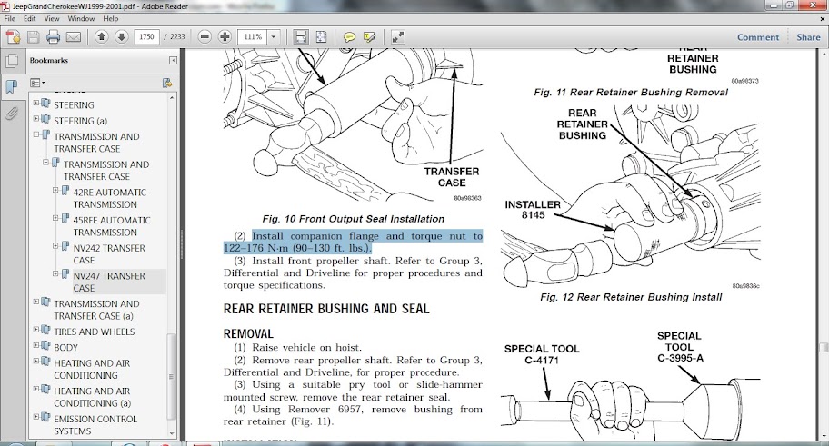

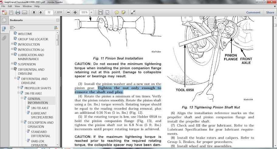

This is info from the FSM for dubs 99-01. It is in reference for torquing the pinion nut (D30) and flange nut (NV247). There is no specified amount of torque in the FSM for the pinion nut... believe me, I scoured it! Here are my screen shots of the FSM. I hope this clarifies a few things for anyone who needs it.
For the HPD30
And the NV247

post #28 of 32 Old 01-03-2011, 09:35 AM
