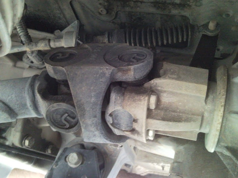

Dude, it's actually pretty easy... I swapped out the CV/Rzeppa type shaft for a u-joint style that came from an '02 Limited. Axle side yoke and straps are from a TJ d30 and I bought the flanged TC yoke and bolts from 6 states. Diff side is torqued to 175 ft/lbs & TC was 160 ft/lbs (talk to Tom Woods or another respected driveline shop and ask what they recommend by way of torque on the TC side... I've heard conflicting responses, but 160 ft/lbs has been fine for me.) I've had absolutely no problems and have about 30k miles on this setup. Altogether I was out $122 including shipping
this will work except for the flange, he's at 4.5in of lift, with a flange he'll likely get vibes, you want to swap yokes on the TC as well, which is as easy as removing the one big bolt and replacing the yokes.
Haha, crap...You're right. I didn't mean flange. I was thinking of the flared seal around the yoke, like in my pic. Thanks for the correction
