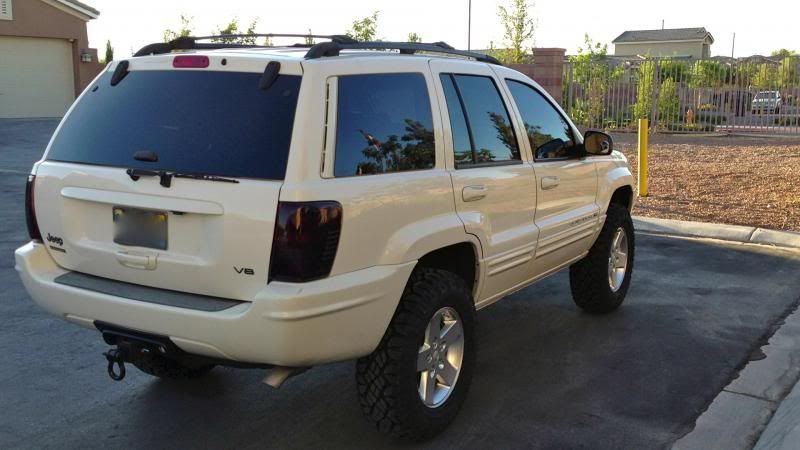

Here's my WJ with 4 coats of Niteshades. I should have done 3 coats, or rather 4 lighter coats (resists the urge to get carried away!). They're just a bit too dark and they're okay for now, but I'll be buying some eBay LED tails soon (the ones that look fairly "stock", like what might come on a stock WJ if it were built in the age of LED tail lights) because even un-tinted WJ tails are a bit dim and the reverse lights are WAY too dim and the LED tails I'm talking about can be purchased with a reverse light that has a bunch of LED's all around it that should be very bright.
Anyway, Niteshades is NOT peel-able. It's as permanent as any paint. I think Plasti-dip actually has a removable tail light tint now that's basically a transparent Plasti-dip that should work just like VHT (more coats = darker). But I imagine it's best for just testing out the look or if you want a dull/flat tint. Niteshades look best (to me) if you clear coat them afterwards and then wetsand and polish for a high gloss tint that looks like the tail light was made with black tinted plastic. It's also the best way to keep the tint protected and not let it get chipped off or scratched. And it also just looks a lot better to me. Just bare Niteshades looks cheap and tacky to me. You need to clear coat it and sand/polish to a high gloss so it almost looks like a tinted window.
