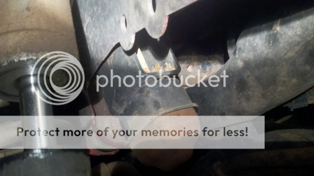

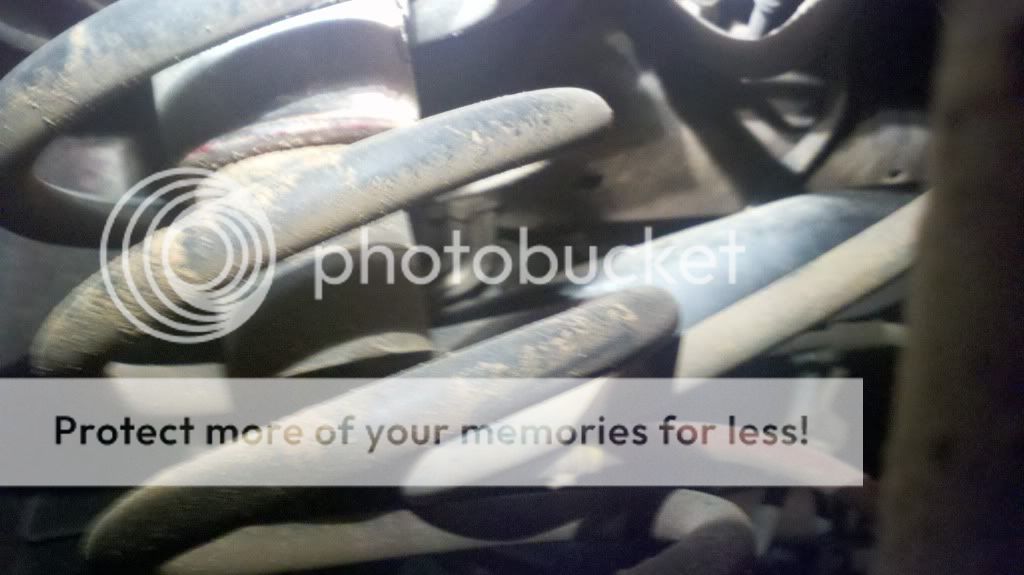

i have 2by4 square tube for my bump stop extensions and so far they are working good so far. as far as the rear you can get some pieces of round tubing cut it to the length you wish and weld a washer on top and bolt it to the coil bucket. i can take some picks tomorrow (its to dark now to be able to see it)

The front.
the rear

looks good, what exactly did you use for the rear was it a hollow piece of round tubing like the front? If so wouldn't the bumpstop just fall into it

Piece of pipe and welded a thick washer to both sides.
