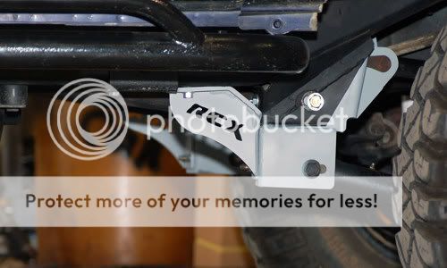

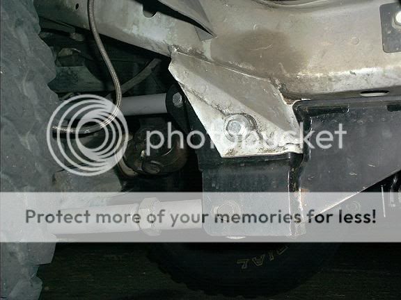

Here's pics of the 3 co.'s I have seen. As you can see, a 4-5" lift has the control arms back to the factory angles. This is the next best thing if you can't afford long arms. (like myself).
Here's the Rough Country ones:
Here's the Rubicon Express ones:
Here's the Rocky Road ones:

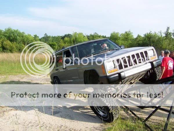

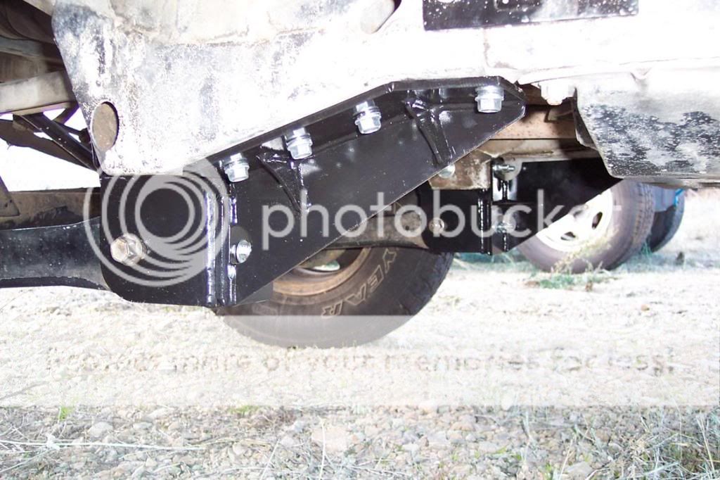

Here's a couple pics of XJs on 4.5" and drop brackets. You can see that this is close to long arm type flex.

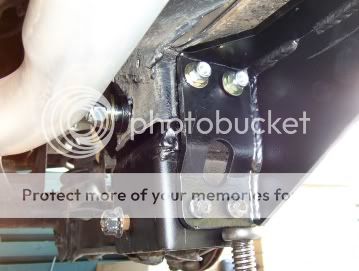

Here's a pic of the RE drop bracket from the backside

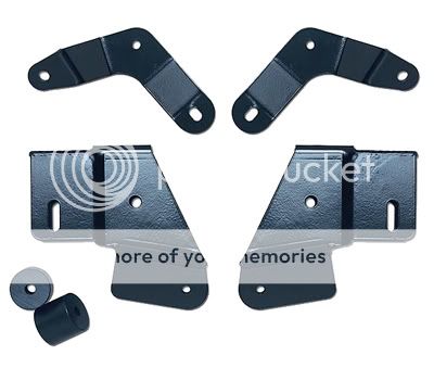

This pic also shows the upper arm drop brackets. I'm still trying to get a pic of the upper arm drop brackets installed, but I can't find a good one. I will keep looking.
