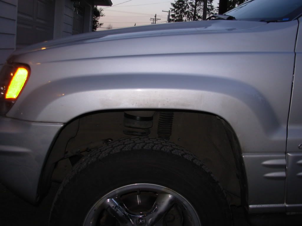

A couple pics of the new stance with 2" BDS springs, 3/4" front spring spacers, Bilstein 5100 shocks, new spring isolators, and JKS Quicker Disconnects.
Hard to get good pics right now because it is still getting dark when I get home, but these are decent. Also, I haven't washed the WJ in a month!
~Richard
