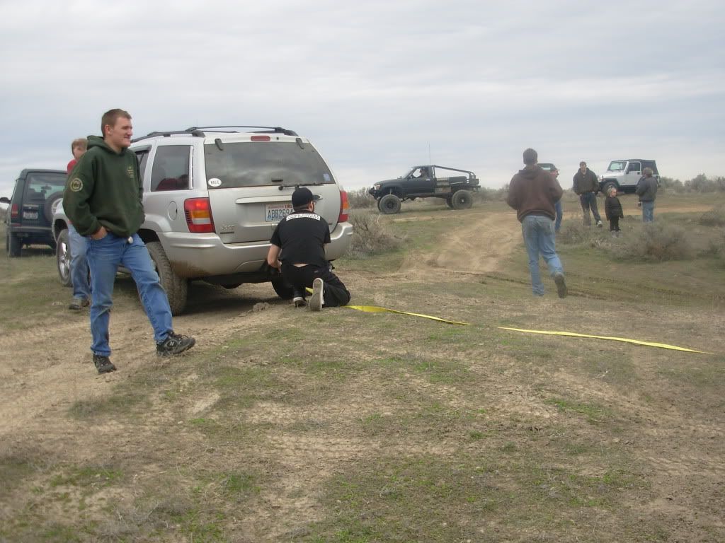

OK so I spent all weekend wheeling, did 11 miles of technical trails, climbs/descents at an ORV area on Saturday and did 43 miles of Back-country travel on old wagon roads in Eastern WA.
Springs and shocks did great. I was very glad I lifted as there were a lot of areas I knew I would not have made it without a lift. I only scraped maybe a half-dozen times and hit a rock slider once. I ran disco'd on Saturday, not disco'd today. I was never wanting for flex and the off-road ride was decent. We hit a lot of terrain today that was much harder than the ORV area, stuff much harder than I expected, and the lift/QuadraDrive/SilentArmors didn't let me down. Only my 29" tires kept me from climbing an aggregate ledge where I didn't have enough purchase to get up. I also pulled out a stuck K5 Blazer and the WJ didn't even squat, just pulled and he was up.
One issue - aired down to 15psi, the left rear tire rubbed a little on the shock. I am running no rear swaybar right now but it is going back on. With the right end links, the rear isn't as limited by the sway bar as the front.
Some pics from Sat:
From Sunday (getting more soon from my friend who took pics of me whilst I took pics of him):
That was a 35-45 hill climb, 1500' elevation gain on loose rocks/rubble. Holy hell it was hard!
