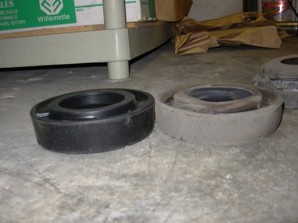

Original thread has too many pictures so I am putting pictures of the upper isolators. They were less collapsed than the front, but easy to replace.
Upper Front
Upper Rear

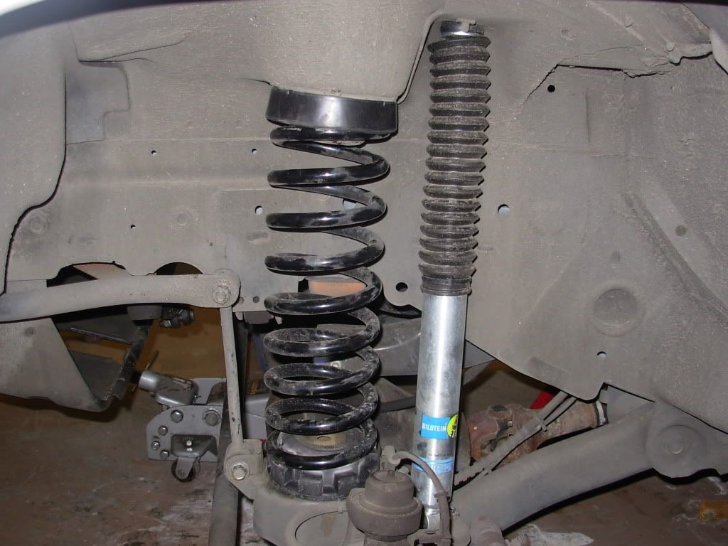

Assembly with new isolators

The bushings should have a little "nipple" that will wind up facing each other when assembled. That little protrusion seats in the hole in the body.
Adding pics of the lower isolators (the really bad ones)
Lower Front
Lower Rear
~Richard

I posted the new dimensions in the original post. But, you are correct. The spring isolators ARE the source of normal WJ sag. Here is the new info that I added to the original (for all those who are subscribed to the thread).
Spring Isolators
This section is a new addition. My lift wasn't quite as high as I wanted and I had inconsistent lift height all around. After seeing what new isolators looked like, I was certain that mine had really collapsed. The results are perfect. The conclusion I can make: collapsed spring isolators are the real source of WJ sagging. Upper isolators are not as much the problem. My uppers were distorted but not totally junk. The lowers were really quite collapsed.
Here's the part numbers you need:
Upper Front: Mopar: 52088 257AB, Moog: K160040, Raybestos Professional: 5771-704
Lower Front: Mopar: 5208 8401, Moog: K160041, Raybestos Professional: 5771-705
Upper Rear: Mopar: 5208 8346, Moog: K160061, Raybestos Professional: 5771-716
Lower Rear: Mopar: 52088 402AB, Moog: K160042, Raybestos Professional: 5771-706
I went with the Raybestos Professional line over the Moog due to warranty, price, pictures, and reputation. The total cost for spring isolators was right around $100 for all 8 from RockAuto If you are looking to save some coin, just get the lower ones. They are the most important and were far more deformed. I REALLY recommend it so you don't have to do this job twice.
As a side benefit, the level of road noise is also greatly reduced and pothole impacts are much softer. Again, I really recommend replacing these, even if you are just getting a budget boost. You will see better results from any lift or even no lift at all - this will put you back to stock height.
Added to instructions:
7a)If you choose to replace the spring isolators, they just pull right off. They may be kind of crusted on there, so pry them up with a screwdriver or something and then clean off the mount. As mine is a West-Coast car, there is not much rust to speak of. For you East-Coasters, I'm sorry but you will probably have LOTS of rust here and you'll at least want to get out a wire brush and some Hammerite/Rustoleum to encapsulate and neutralize the rust.
Spring seat with spring isolators removed
This image has been resized. Click this bar to view the full image. The original image is sized 1024x768.
7b)Install spring isolators with tab going into hole on spring seat. The bottoms have a tab on both front and rear axles, but the tops just pop into place.
