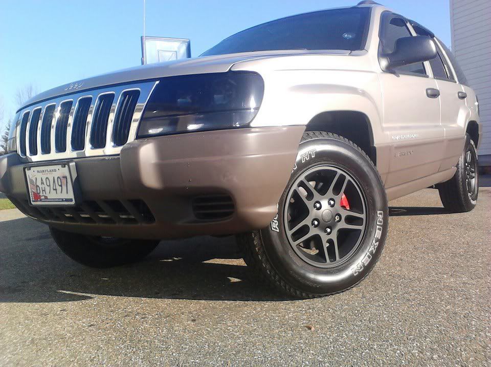

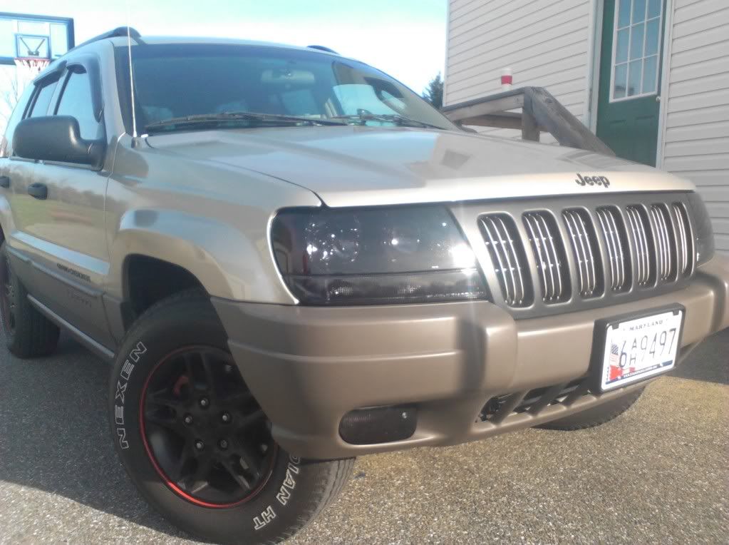

Yes. There are a couple of write ups on it on here and JU. I got my fog lights from WJ in a junkyard for $10, put them in with trim adhesive, and ran wires back up to a switch in my center console.
Before:
After:
Switch:
In the garage: M1 4bbl

McClouds what did you black out your rims and grill with it looks great
Thanks. The rims and grill were painted with Plastidip from an Aerosol can. The mesh behind the grill was painted to match the body with some stuff from www.automotivetouchup.com that I had leftover from repairing a dent. I also put a piece of red colored vinyl trim adhesive stuff around the edge of the wheel to match the red calipers.
Do you have different than stock bulbs in the fogs and headlights since they're tinted?
No I don't. The tint I used is called VHT Nightshade. It's a spray on tint that comes out really really nice if you do it right, and doesn't detract from your headlight's brightness. I got a set of made-in-China head lights off of ebay for like $40 and used it on them. I put the Silverstar 9006 bulbs (which I think is what was in it from the factory?) in the headlights. They're about 2X as bright as the old foggy OEM ones that I'd had on there before.
