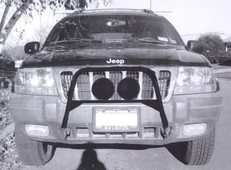

Recently I've been looking at lightbars/brushguards for my jeep. The ones Westin makes slaughters your ground clearance and they're made from nothing more than exhaust piping. One of my friends owns a shop the caters to custom motorcycles and I contacted him. I had seen Dfloyds lightbar that he made and how it came off of the tow hooks and I liked it alot. The only thing I wanted different was I wanted it to me higher up and the lights in the hoop to protect them. I also wanted to angle it out a little so I could have more of a brushguard/lightbar. I eventually came up with an idea like this. I'm open for input about it before I get it welded up. I'm still undecided on whether I want to finish it with powdercoat or a linex like material. Let me know what you think!

It's just my opinion but I think you need something that covers a bigger area in front. It just looks to small and wimpy. I would either go bigger or go a lot smaller and just add a simple bar with lights. Just my $.02 though

What do you mean by cover the bigger area in front? Do you mean the area under the bar down near the radiator?
edit: Didn't read your post correctly. I don't plan on doing extreme offroading just yet. Maybe driving through some fields and some mud but nothing that would constitute a huge all steel plate bumper. It's going to be made from thick wall DOM steel tubing so it should have some pretty decent strength. Other than what I previously stated, I also want a little added protection from deer late at night and from hitting fences driving recklessly in a snowstorm(DOH!)

i have a westin safari bar that mounts were the front skid goes and i know the lights are low on it but.
you can mount lights behind the grill, on your bumper inform of your grill or the roof.
i know the bar mounts are low, but not lower then your cross member.
when i went wheeling at the end of October i did not hit the mounts once and they did not get in the way.
the mounts have really been good and strong from saving my bumper from being destroyed when bottoming out on a pothole when driving around in the city. it has happened to me a few times were a hole will be deep and my entire wheel would going to it and would hit both bar mounts. they would take all the blow.

Compcrasher- He's already quoted me at $180 to get it made. The guy used to work at Rock Krawler and he said he wants to start making some stuff for WJ's. I'm sure after mine he'd be more than willing to make another

180 isnt bad for keeping the stock tow hooks I guess but its pretty pricey if you remember that Westin (an overpriced ripoff corporation) safari bars can be had for $170. I guess its custom labor and all so thats a premium you pay. Ehh its still worth it lol

He's going to be building it a lot stronger than the westin ones. He's using 1 5/8 tubing with .25" thick walls on it. He's also going to use 1/4" or 3/8 gusset plates where needed. Also on the piece that get sandwiched between the towhook and towhook mount he's going to be using 1/4 steel plate. I was told that when it's done I'm going to want to aim for deer I see crossing the road.

It's essentially going to be built like a brick s**t house.
