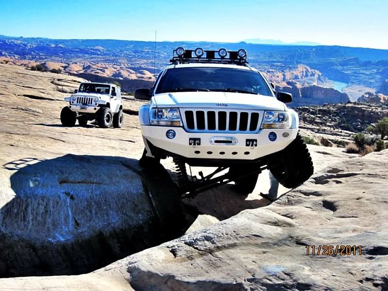

Here is my WJ on stock lines (Thanksgiving 2011), they run pretty close to the path of the long arms...you should be fine offroad.
Are your lines disconnected?

The only line disconnected Is the rear line... the one from the body to the junction on the axle. Stock, it attaches to the a-arm. But as I don't have a stock a- arm, mine just hangs in the air.
