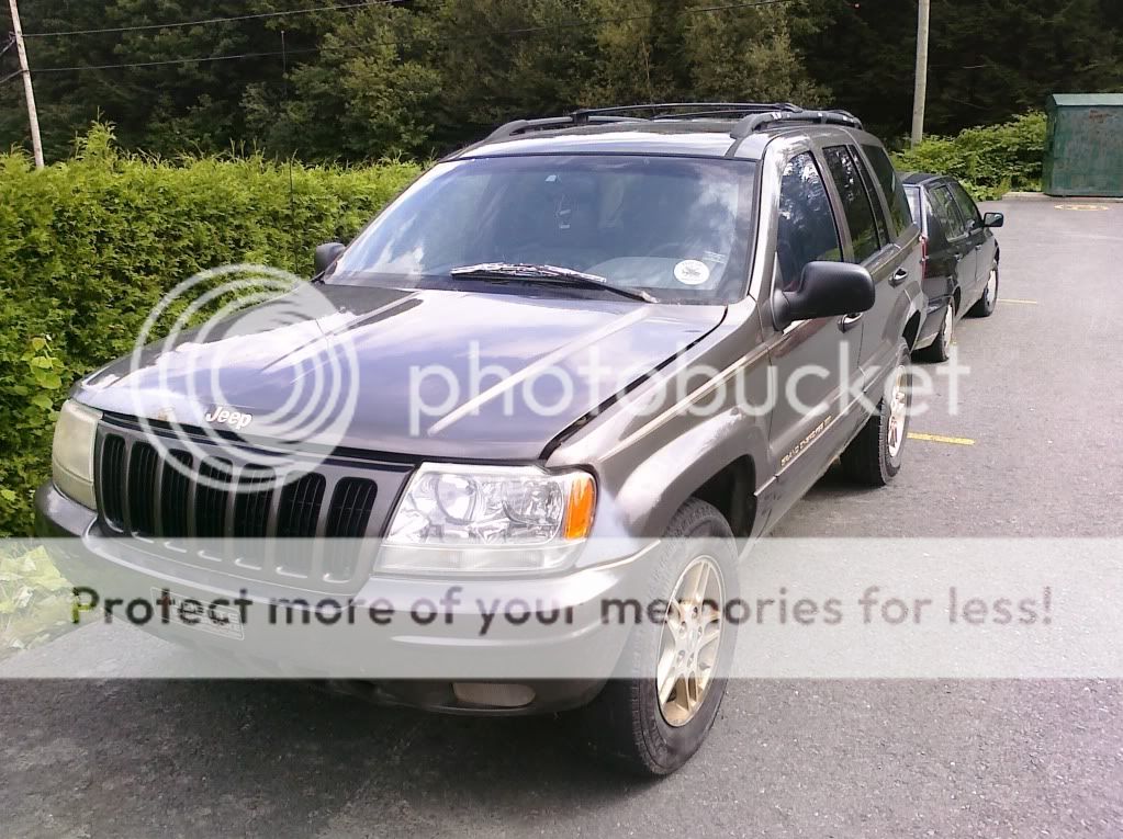

I'm new to these boards and I only bought the Jeep yesterday... I paid only $300 for it and everything works... except I fear (assumed actually for the price I paid) that the engine is either on it's way out or driving it back home finished it. The gauges are jumping around randomly... every single one of them... when the engine runs, it's extremely rough, sounds worse than a diesel engine... When I got home I realized the oil gauge was empty... it wasn't when I left... I only drove maybe 30miles to get back home... I also noticed the dipstick isn't in there anymore for the engine oil... the small yellow cap is in, but no dipstick and alot of smoke is coming out from in there after the engine warms up. It also stalls if you stop at a light, clicks when you try to restart it, but eventually does restart... and it's backfiring like crazy...
Now I'm just gonna go ahead and assume I need a complete swap of the engine... but is there anything I could try first? Fresh new oil, filter & dipstick? I don't have far to go to get to the garage for the swap and I rather not pay +$100 to get it there...
Also, when I brake it jumps around, I'm assuming warped rotors?
Thanks in advance...

Sounds like its been beated up pretty bad lol...any pictures ?

^ Video of the engine running... I added 6L of oil... I'm assuming the gauge reads 5.4L because that's how much oil fits into the crankcase/filter/etc...? Anyways you can see in the video it reads about 4 after adding 6L... it's starts great and runs hard, but runs when it has oil in it
rocker panels are rusted out, other than that there are 2-3 fist sized spots that have been primered... everything works, cept the back wiper (new motor) and blower... also the back door won't open, but I read somewhere that that is a relay issue, and there is a way to override it?
