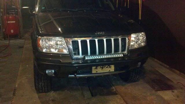

post #27 of 42 Old 10-08-2013, 04:46 PM
atvlifestyle
Join Date: Jul 2013
Location: stevensville
Posts: 81
Originally Posted by Fawkes View Post
It doesn't look like it would work with our stand-alone tabs as shown. Our tabs tuck up tight to the fascia in the exact same spot as their mounting plates. You'd have to (at the very least) drill a 7/8" hole through their plate in order to attach a shackle, putting it through both assemblies.
I am hoping that the width of the bracket would work out that I can cut it so it will just get welded to the side of the Stand-alone tab. Figured I would have to drill it to run the shackle through both.
hope that made sense. I willl hold out to order till ive seen better pics of the mount.
atvlifestyle is offline
post #28 of 42 Old 11-03-2013, 07:12 PM
atvlifestyle
Join Date: Jul 2013
Posts: 81
Installed the lightbar with the Fawkes stand alones today. I ended up using both brackets together. Had to drill the holes for the lightbar bracket out abit but ended up working fine. I still have to drill a hole for the shackle shank to go through. I was going to weld it together but dont think that I can can get the bumper back on with the lightbar bracket installed. Ended up tacking the nuts to the top plate and then the plate to the unibody channel. So everything can be mounted or removed with the bumper on.

post #29 of 42 Old 11-03-2013, 07:59 PM
NU_WJ
Join Date: Sep 2013
Location: Denver
Posts: 125
Nice work! Looks awesome!
NU_WJ is offline
post #30 of 42 Old 11-04-2013, 08:38 AM Thread Starter
mdrum93
Location: Lexington <> Boone
Posts: 430
Yeah looks great! I like that much more over a bull bar.
