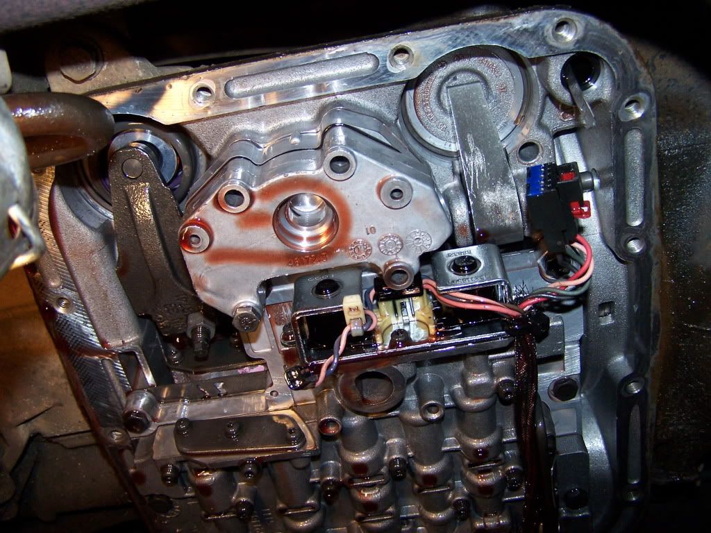

If your transmission started acting up like mine, this might fix your problem. The other day my check engine light came on and then when i tried shifting the jeep in D, the transmission would automatically shift in 3rd gear and it felt really sluggish to take off...unless i shift it manually in 1st. I then checked with the obd2 reader and i got the code p1762 and 1763...which is the governor pressure sensor improper voltage i think. Anyways i erased it and my jeep ran fine for a few days then it came back...and lately the transmission actually was stuck in first gear until 3500rpm...so i went ahead and i bought a governor pressure sensor and solenoid, a new filter and some atf4...i took some picture and hopefully it can help some of you guys.
I strongly suggest doing it yourself...unless you are really a dummy or you have absolutely no access to basic tools...any shop would rip you off because it sounds wayyyy more complicated than it is. Took me 2h from start to finish.
The new parts, Governor pressure sensor on left and solenoid on right.
Take the pan off.
This is what you should see...all the pictures have been taken from the passenger side looking at the driver side.
Remove the filter. 2 torx screws.

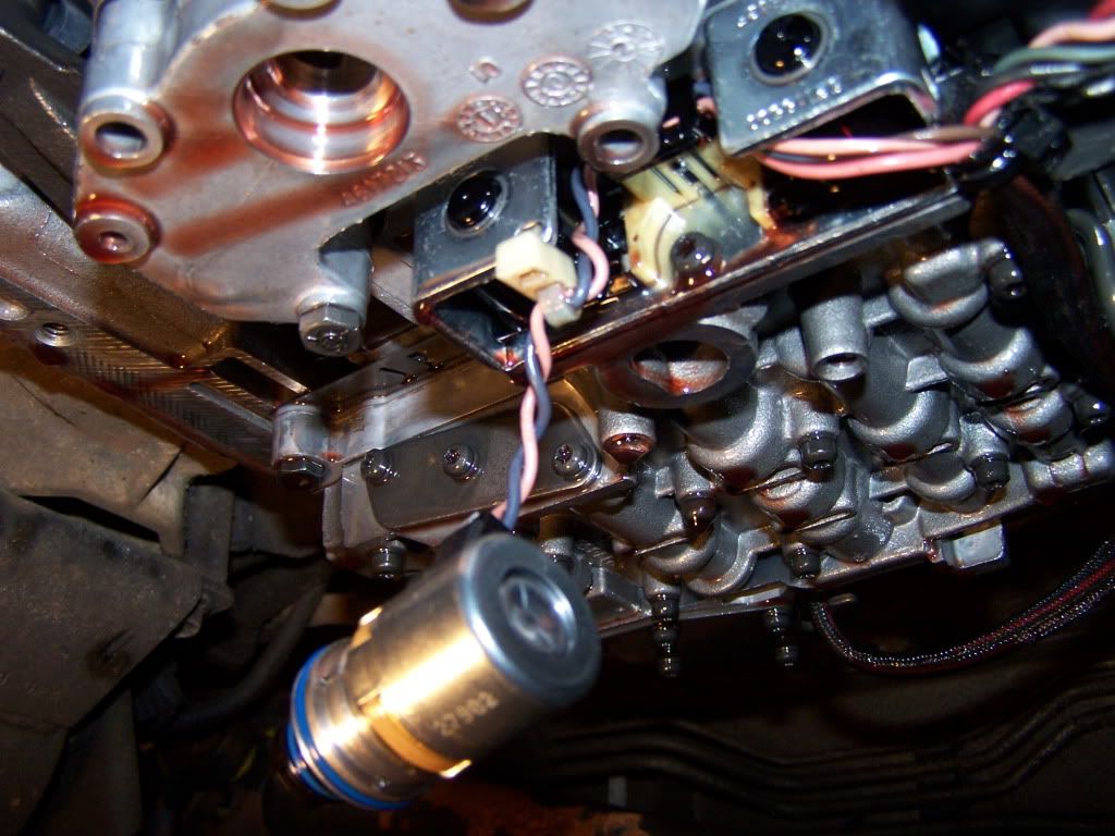

Picture of solenoid on the left and sensor on the right.
Remove the clip holding the sensor.
Now you need to remove the metal bracket that holds the solenoid...2 torx screws and 3 11mm bolts i believe. The solenoid should fall right off. The harness will hold it so it doesnt fall on the floor.
Remove the sensor and the solenoid...they are both stuck in there because of a rubber gasket kinda...they will pull right off.

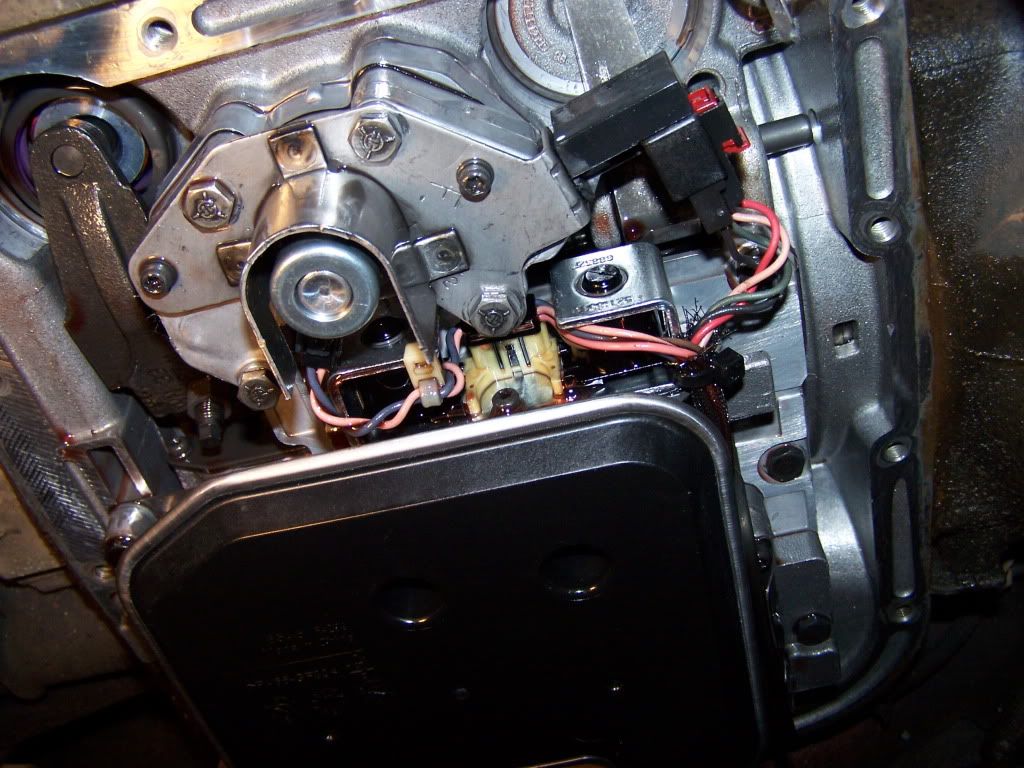

Instal the new parts.
Put the metal bracket back on and the new filter and you are done.
Make sure all connections are properly attached. And also make sure there is no dirt or debris on the valve body.
