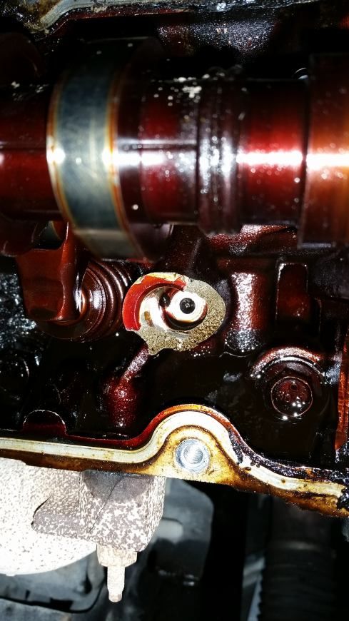

Thanks for the quick reply MikesBean, got all my parts ready to rock and roll tomorrow, you've given me a new burst of energy i was feeling real down after spending all day yesterday stripping her down to find the dreaded smiley face damage
My Rocker arm fell off too in the process and somehow dislodged the hydraulic lifter which in turn smashed it housing it slides into

Thanks for the quick reply MikesBean, got all my parts ready to rock and roll tomorrow, you've given me a new burst of energy i was feeling real down after spending all day yesterday stripping her down to find the dreaded smiley face damage My Rocker arm fell off too in the process and somehow dislodged the hydraulic lifter which in turn smashed it housing it slides into
That motor internally looks horrible. The color from the oil I've never seen on aluminum engines that were properly maintained.

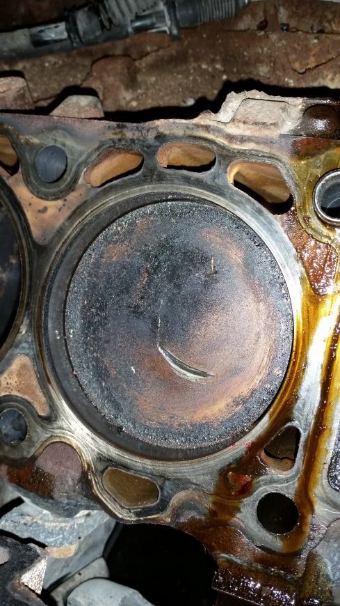

Yours looks better than mine a little! Just a little light polishing on that smiley face…and be sure it is really clean in there!
I had a mobile type mechanic do the work at my house to help and I managed the event. I had to piss and moan to get them to pay attention to the torque values.
I am no professional…BUT I am magic to know when it is being done right!
I had to lear about ANGLE TORQUING on the HEAD BOLTS and make sure we tried to do it that way!!!!! THERE ARE NO TORQUE VALUES FOR THEM!!!
Questtion: Is your CCV Hose tube system missing/cracked or plugged off on the head(s)
Be sure that PVC system is hooked up with ALL the plastic pipe.
AND the CCV (crankcase vent tubes ) - A lot of folks ignore these or plug them off!!!! (BAD) and sludge builds up in the heads. I have heard it a lot on here.
I had a rubber connector split in the back driver side . I went to ebay and ordered the whole hose tube system with hard plastic and rubber connects. Pretty Cheap to get it right!
Will do good for a new head.
Which side and cylinder is that dropped ring?

Passengers side
