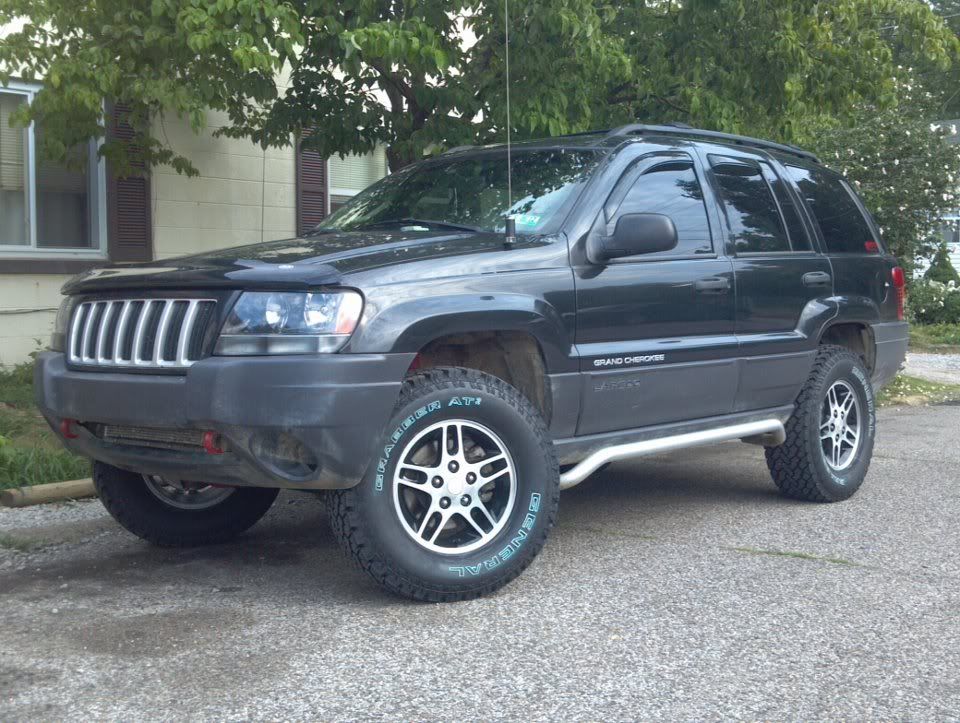

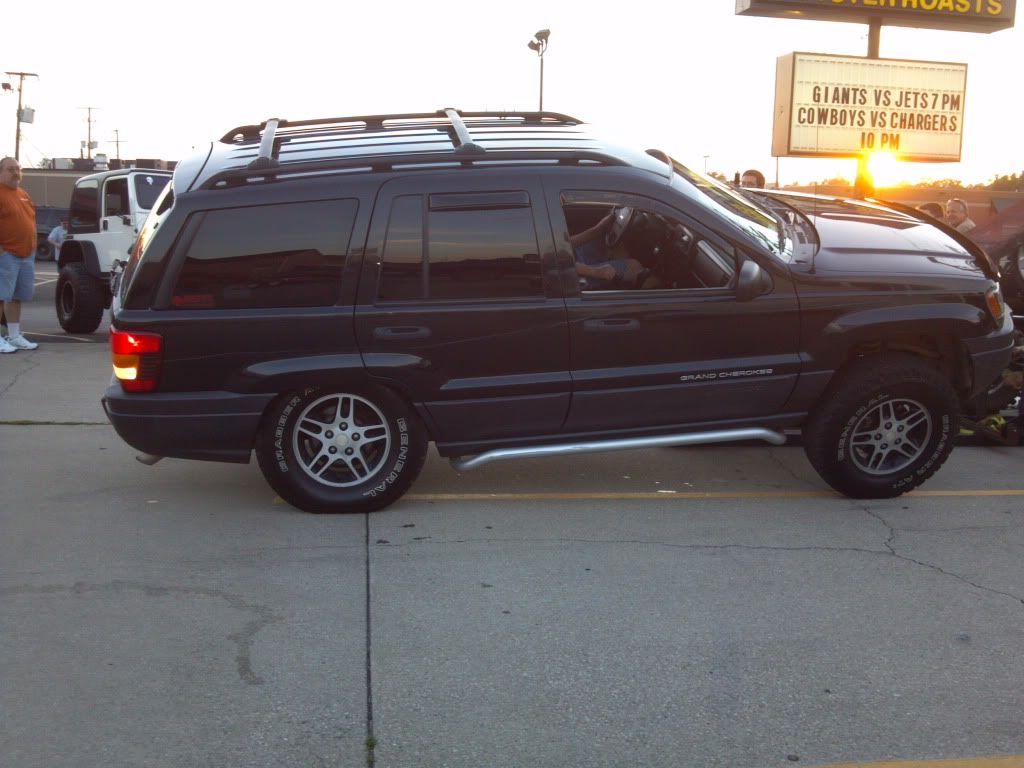

I just went from 245/5r16 to 265/70r16 on stock silverblade wheels. Here's some pics. Note I have a 2.75" KOR suspension lift and had to trim a bit on the inside of the front fender (under the fog lights), but not noticeably so. And I run 1.25" spidertrax wheel spacers.
245's:
265's:

I only had the 245's on without the spacers. They fit and worked fine, no rubbing inside or out. I wanted a little wider track, so I put the spacers on. I would think that I would have needed to anyways with the 265's.
