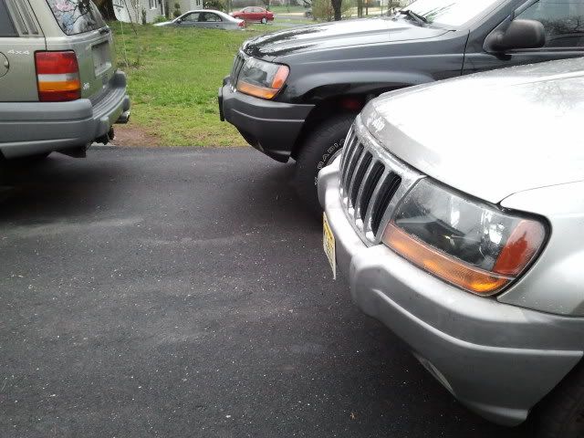

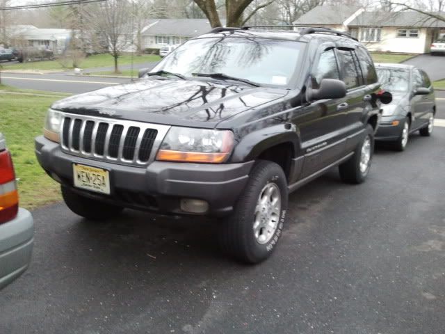

BB with UE coils I havent done back yet but front springs are gonna be all around. Heres a pic next to a stock wj with just UE coils

somebody likes their Grands^^^
your WJ (black) looks pretty nice man.
