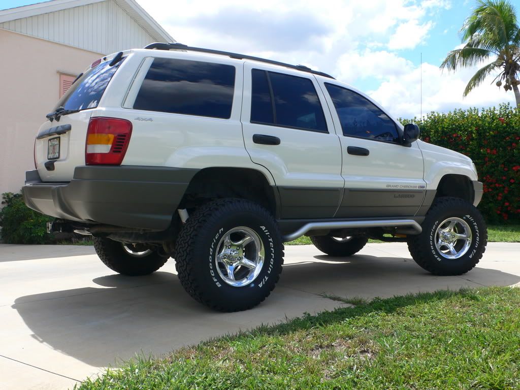

I put aluminum 15's on my WJ.No spacers,I believe 3.75 back spacing.

I love the look of the 15" wheels on a lot of guys WJ's on here cause they make the tires look huge compared to mine. I have even seen tires smaller than mine that look bigger and more aggressive just cause of the 15's. Nice rig Seneca!

Nice wj Seneca, I think I'm gonna start looking for some 15's for my jeep and probably run the 33's it will be a lot cheaper on tires and wheels. thanks everyone

kinda hard to tell, but they are 15s. steel rims are stronger than aluminum too.
