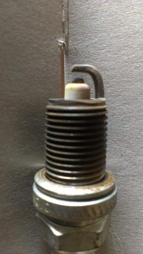

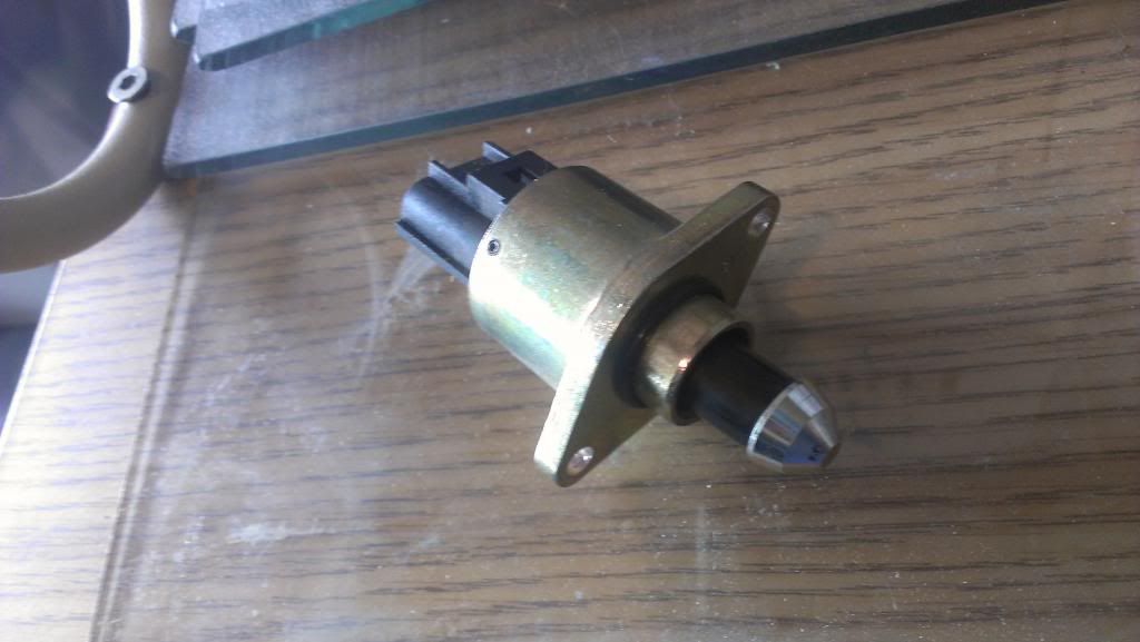

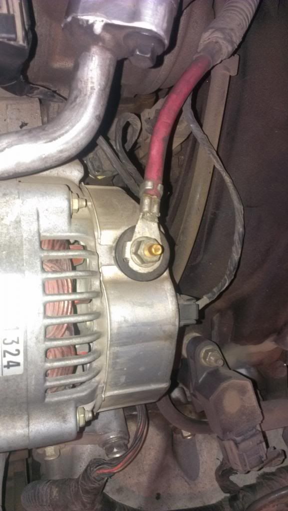

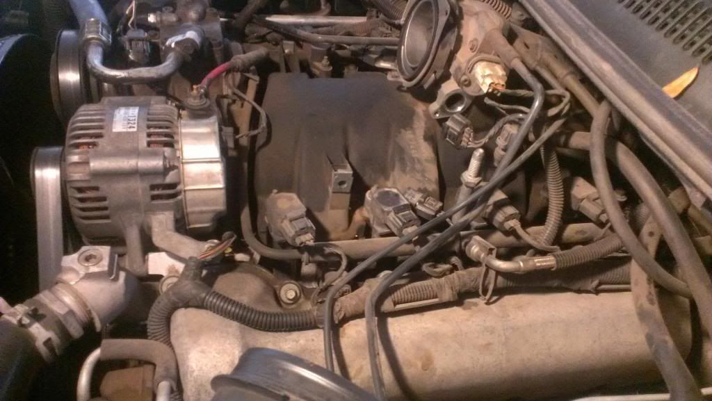

Here are some pics that are just random but I took them anyways...lol
1. Looks like the wiring going to the ALT is just fine. Started jeep and unhooked battery and it just keep running.
2. The IAC (or whatever) looks clean and almost brand new.
3. Plugs looked used but not like "holy crap". Still I'm replacing them all with new ones anyways. Also all the coil packs look like new.

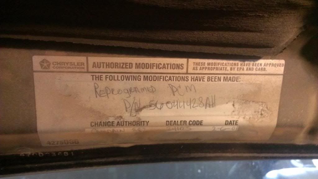

Originally Posted by cmberges View Post
That is exactly, to the T, what is going on. So ill try the list out and see what happens.
Also would this be a good replacement part (PCM)? Lifetime warranty so...?
http://www.ebay.com/itm/JEEP-GRAND-C...feca9c&vxp=mtr
Looks like it was flashed in Feb. '01.
