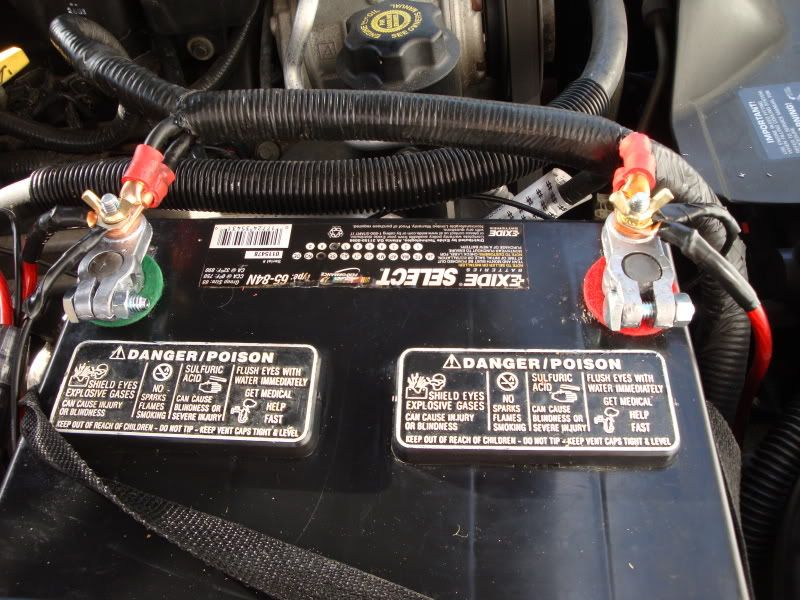

Mine did the same. My battery terminals were corroded and would not tighten down... I replaced them and my problems were solved. Search battery terminal replacement in the form.
