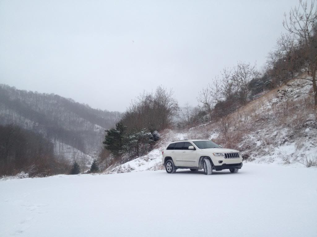

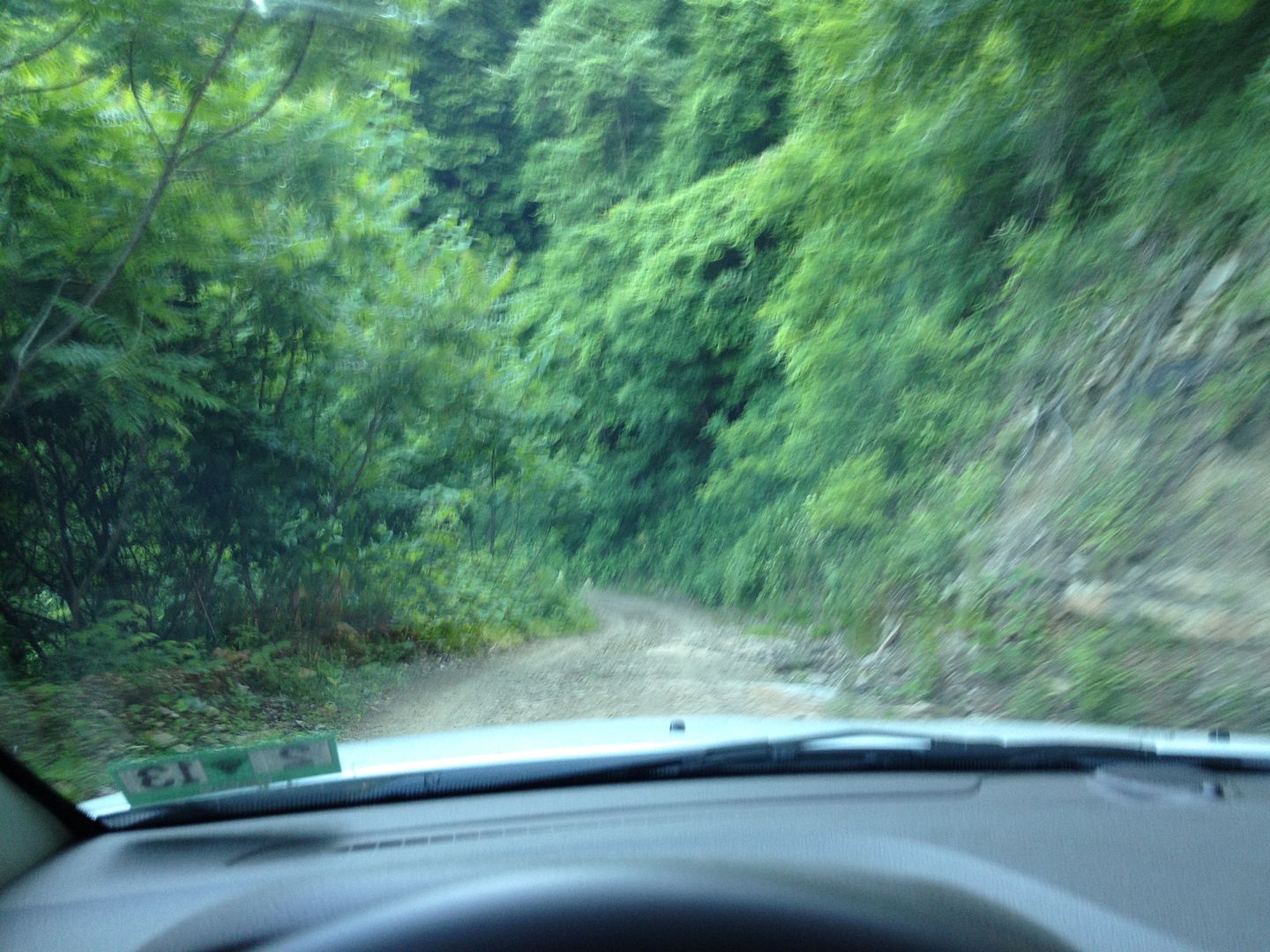

ive been from mountains to snow to sand. no issues. just punch it and go.
i had no desire to take this suv where i have had my last trucks, so i didnt want 4 low.
qt2 seems to have an issue with sand, and i bet snowy roads too. qt1 is locked at a 48/52 split where qt2 can transfer 100% to either axle. after several miles qt2 seems to overheat the clutch packs when i normal 4 high. qt1 doesnt seem to have this issue.
i think on roads, jeep qt1 is better than most pickups part time 4 high system.
i have made it up a untreated snowed in drive way on one attempt( actually i was riding passenger, my wife was driving) where a 2010ish silverado crew 4x4 with a/t tires took three attempts and he had the factory rear locker.
how qt1 works, rear tire off the ground front driver in muddy ditch.
<embed width="600" height="361" type="application/x-shockwave-flash" allowFullscreen="true" allowNetworking="all" wmode="transparent" src="http://static.photobucket.com/player.swf" flashvars="file=http%3A%2F%2Fvid227.photobucket.co m%2Falbums%2Fdd205%2Fjustinnelson_01%2F005.mp4">
now pics.
all that being said your 14 has better gear ratios. my v6 with the 5 speed, just punching it from a red light it will hit 53 mph before it redlines first and shifts to second. the 14s seem to do about 35mph. i like that better.
but try it out i bet it surprises you in bad weather and off road.

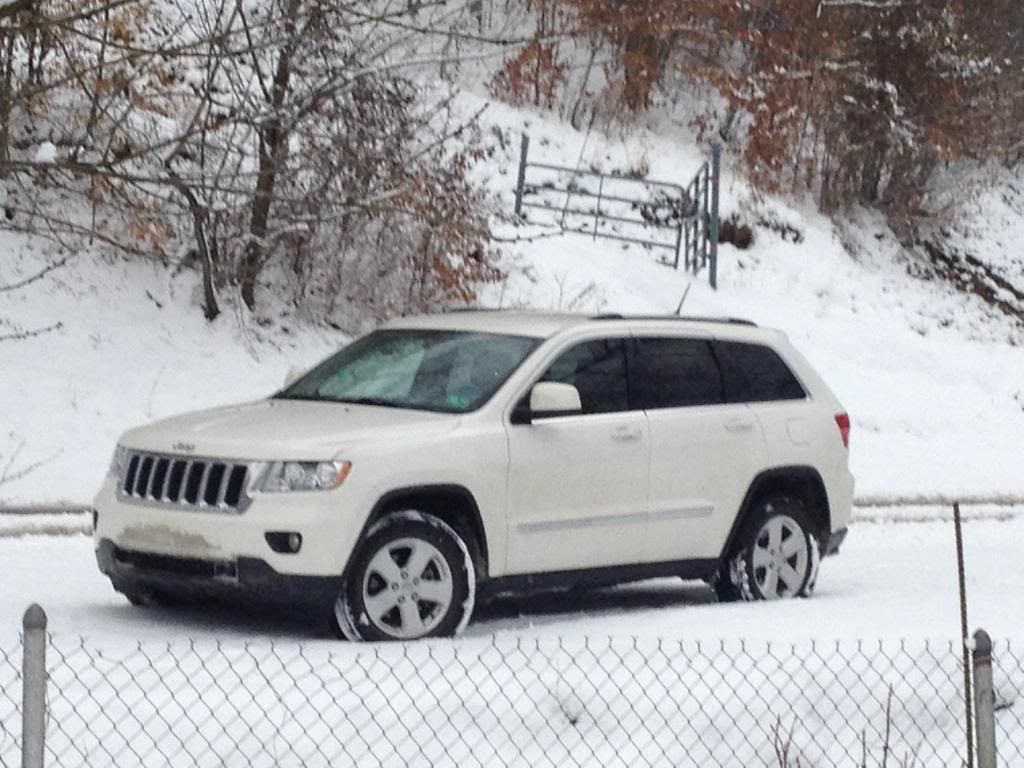

see its a jeep it will go..
my wife likes to yell "it's a jeep b*tch" when she plows through bad weather lol
i took it up to the shooting range. up at the range the wind was blowing and was about an inch on the road.
i did kick it sideways on an ice cover parking lot, but counter steered and powered it back straight.
also on a low speed steep hill decent using 1st and brakes i have a ding and abs light with the esc light kick on, abs disabled and make the hill alot easier to go down. it was about 3-4 inches at the point and took me turning it off stepping out locking it, then unlocking and restart to get it to reset.
