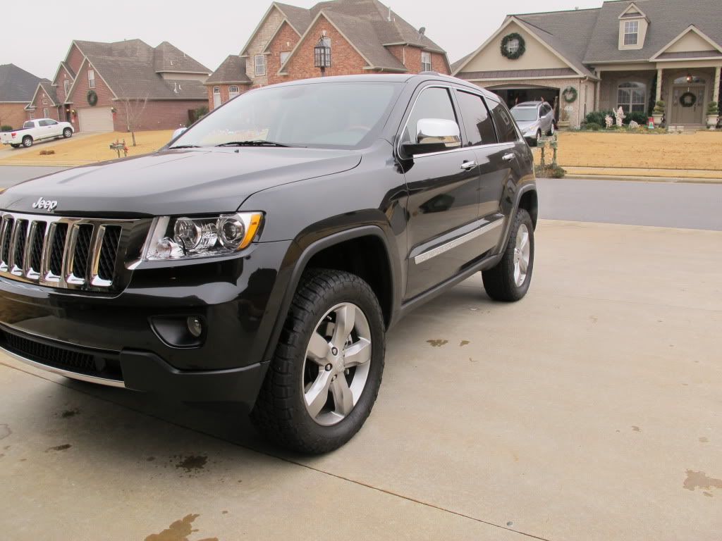

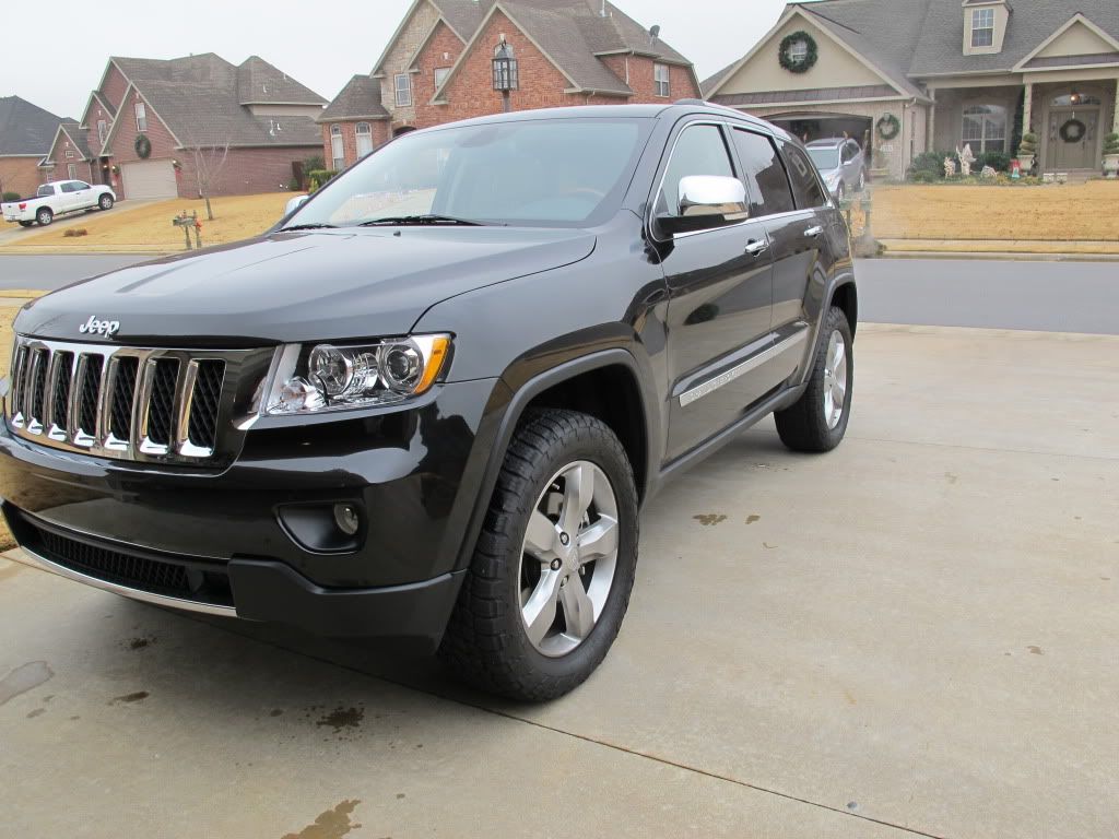

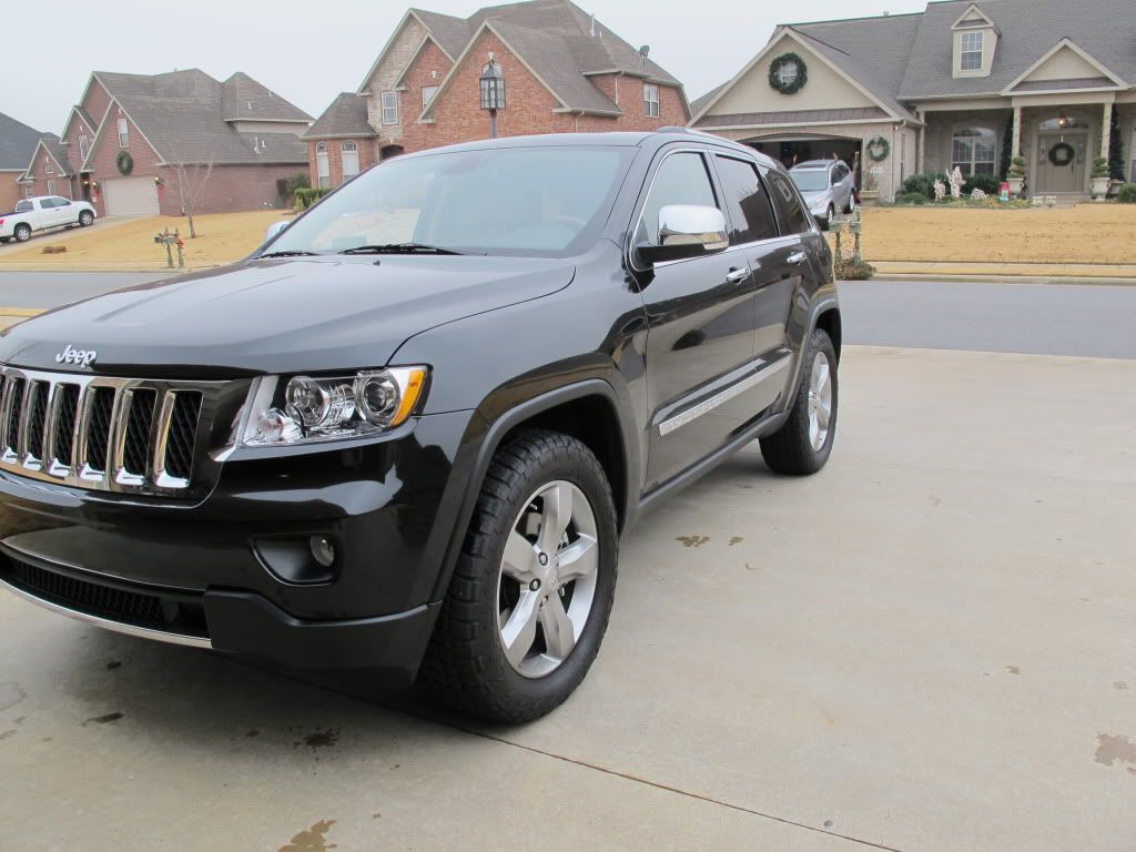

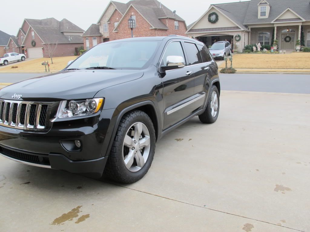

Here is the different angle as well as the same picture at each quadralift height.
