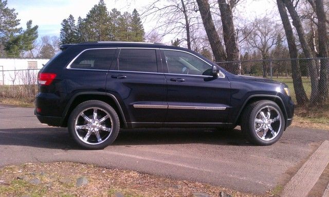

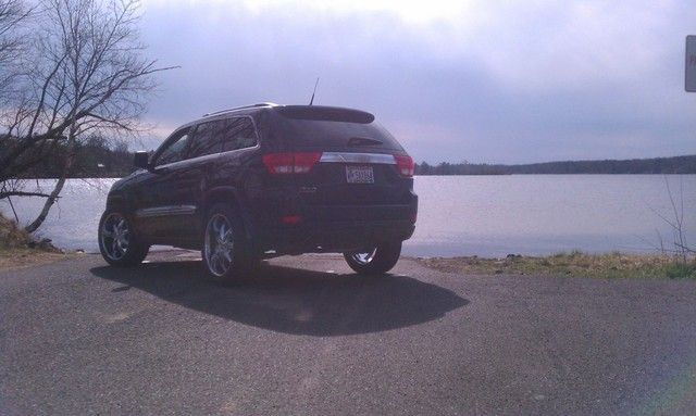

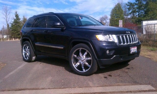

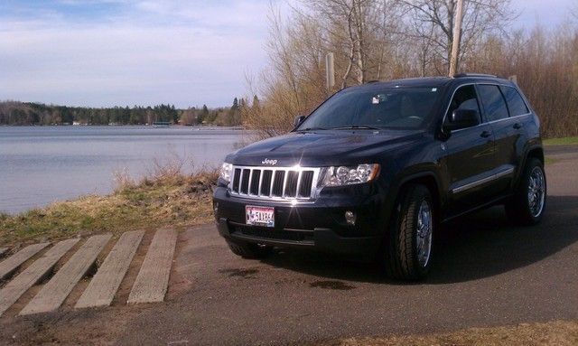

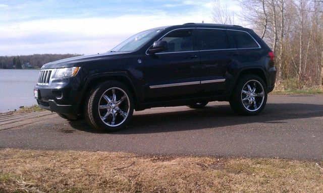

Got some new shoes today..
So my GF just got her new wheels and tires today. Pretty excited for her as its new to her and first set of wheels she has bought. I ordered her Toyo Proxes ST II 285/45r22 and they are mounted on 22x9.5 (preferred the 8" wide but they were out of stock..) +13mm offset. They just kiss the front side of the fender flare while turning under compression. The outside of the tire is right off the edge of the flare, just how I wanted. Let me know what you think
Im gona lower the rear about an 1-1.5" and add bags to the coils in the next week.

Very nice!
