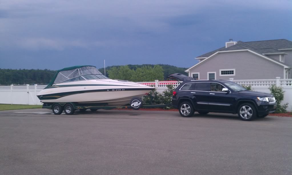

I tow our approx. 6300lb (boat, trailer, and stuff) and you barely notice it there even without a weight distributing hitch. The trailer has brakes which is important for something that heavy. I've also seen a WK2 pulling a pretty large AirStream looking travel trailer, made the Jeep look tiny. There's some threads on towing if you search.
