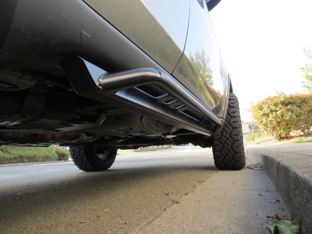

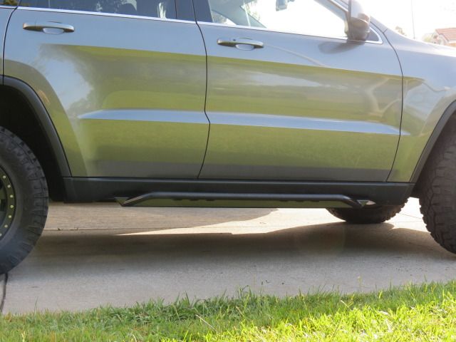

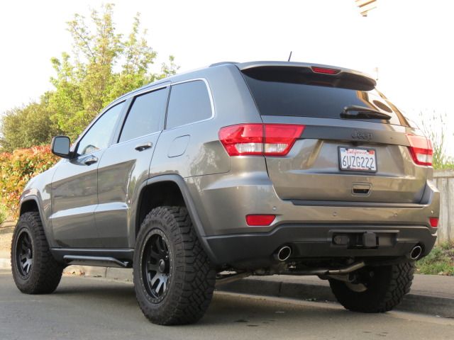

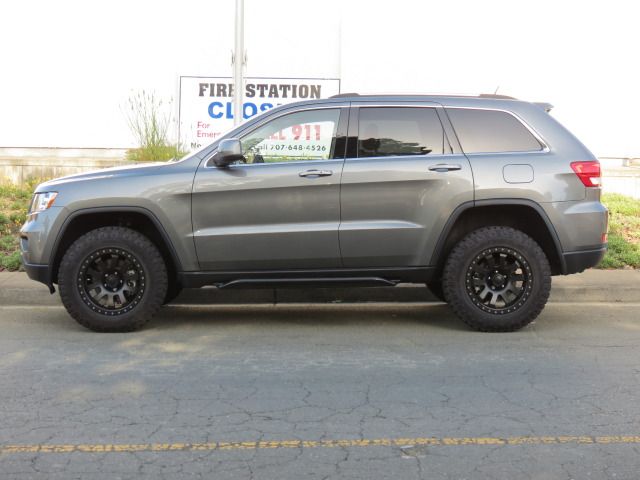

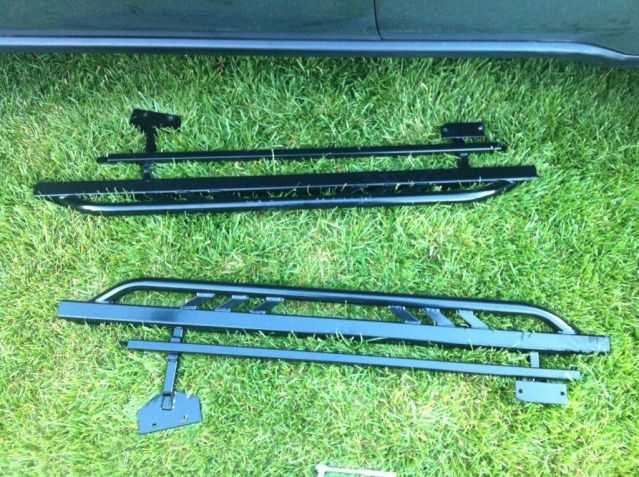

Rocky Road Slider Install
Original thread here: http://www.jeepforum.com/forum/f309/...alled-1362918/
Finally got around to taking some pix and video of the new rock sliders. The install was pretty strait forward. These do require you to drill into the uni body which wasn't to difficult. Except, I didn't pay attention on the passenger side when drilling one of the holes and the alignment was off. I was able to save it though.
Once you drill the holes you then have to use self tapping bolts which took some muscling to get them to catch. I recommend pulling off the slider after drilling the holes and use the drill and wiggle it around a bit to make the whole slightly bigger. Then once you get the bolt to catch on all the holes pull it out then put the sliders back on and bolt everything down.
I did this all by myself but could have used another set of hands. It does take pressing really hard on the self tapping bolts to get them to catch. I'm 6'4" 260 and it took me pressing as hard as possible.
Video:
Pics:
