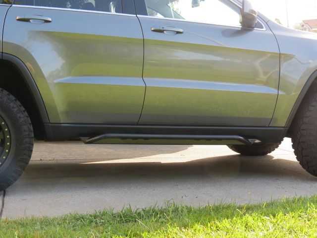

Rocky Road Slider Install
Original thread here: http://www.jeepforum.com/forum/f309/...alled-1362918/
Finally got around to taking some pix and video of the new rock sliders. The install was pretty strait forward. These do require you to drill into the uni body which wasn't to difficult. Except, I didn't pay attention on the passenger side when drilling one of the holes and the alignment was off. I was able to save it though.
Once you drill the holes you then have to use self tapping bolts which took some muscling to get them to catch. I recommend pulling off the slider after drilling the holes and use the drill and wiggle it around a bit to make the whole slightly bigger. Then once you get the bolt to catch on all the holes pull it out then put the sliders back on and bolt everything down.
I did this all by myself but could have used another set of hands. It does take pressing really hard on the self tapping bolts to get them to catch. I'm 6'4" 260 and it took me pressing as hard as possible.
Video:
http://www.youtube.com/watch?v=UcRWr...ature=youtu.be
Pics:
2012 Laredo X 4X4, 5.7 Hemi, luxury package. Mods: 2.5" RR lift, ProComp 7036 wheels, 275/65-18 Wrangler Duratracs. Pics in my gallery
Mild wheeling in my WK2:
index=2&feature=plcp
Big50 is offline

Once you've wrapped around the board, you can re-attach the hardware pieces. Since you've got them off, it's not a bad idea to give them a good cleaning and use some sort of protectant on them (I used Turtle Wax F21 - this stuff works great but makes it very slippery, so make sure you give it a bit of time before you intend to step on them).
You can see in that picture an area where I jacked it up. This film supposedly has air release and should fix that. We shall see in the morning.
I put it back on the Jeep just to see how I liked the look. I do like the chrome, and the vinyl looks great for chrome. However, I didn't do very good job with it, and so it didn't turn out as well as it could have. I have no doubt a professional with this film could make these look flawless, and fantastic, but the RVinyl chrome is somewhat difficult to work with.
Overall, the product is good, with awesome looks - it looks as good as a lot of OEM "chrome". But it's hard to work with, so unless you are pretty skilled with it, I'd limit it to smaller areas. And don't try to use heat on it

It didn't actually look that good. I did a pretty terrible job In putting it on, so I had ridges and such at the ends of the bars. So, I took it off already. I expect that it would have held up pretty well had I left it on.
