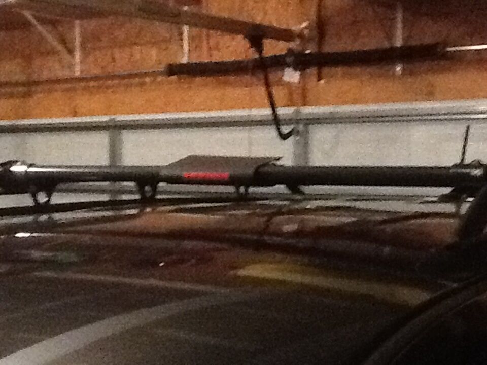

Here's mine with the 44 inch fairing - I had to trim the sides a few inches. I taped them and then cut them with a jigsaw with a very fine-toothed blade. A little sanding and the look perfect. I frequently drive 80 mph or so and hear no wind noise whatsoever from the bars. At some point I am going to drill a small hole in the bottom on both sides so I can attach them to the bars - the fairing will flip up when I got through the car wash. I am very happy with the results.

The rack and fairing look good. I'm probably going to go this route as well. By chance do the Yakima letters come off?

Not easily. You can see (if you look closely) that I tried to black out the "Y" with a sharpie marker. Unfortunately it wore off pretty quickly. You might be able to sand them off although I think that would look bad. The best bet might be to paint the whole thing.

jdhunter, fairing looks great, thanks for detailed pics and description, I will look to go this route as wind noise was only concern on getting RRO bars, actually any bars for that matter.
