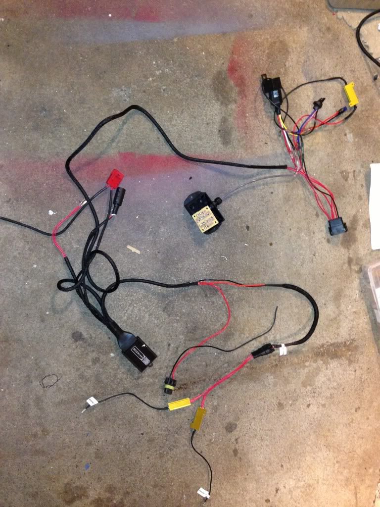

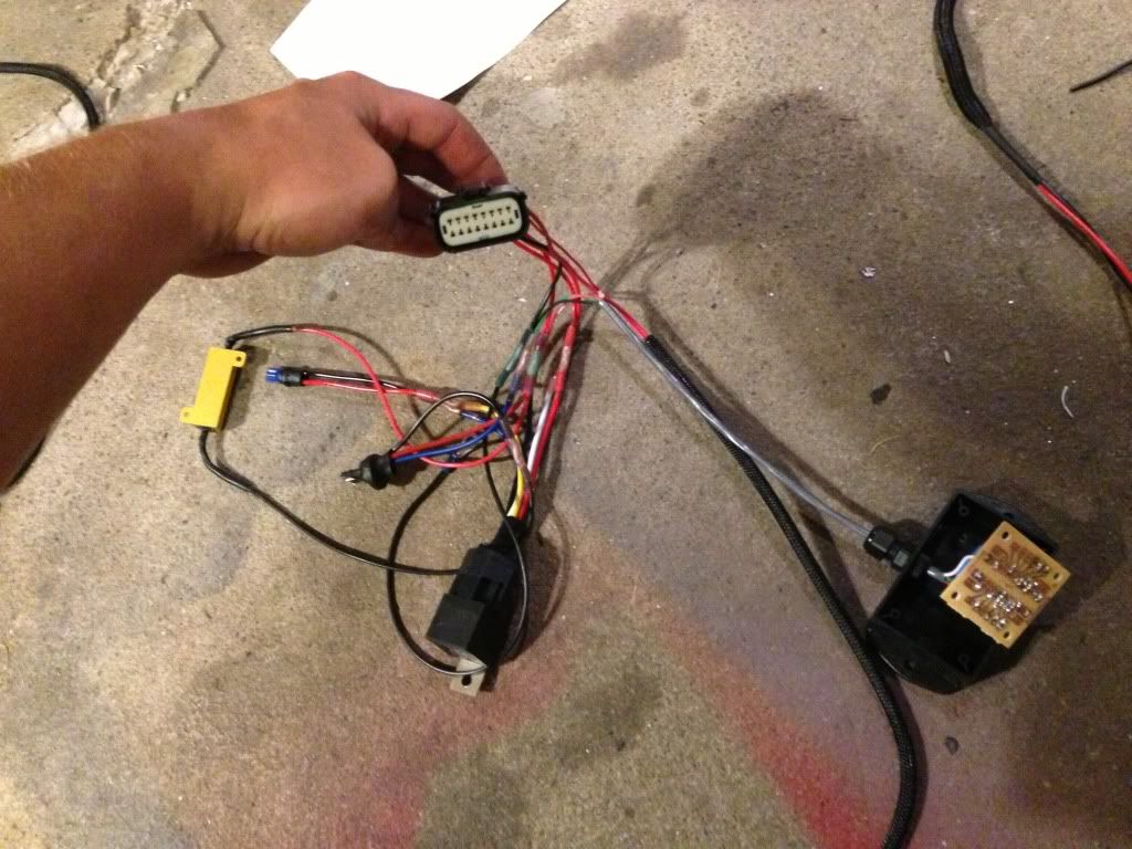

Got a few pics of the harness coming to life, it's a piece of wiring artwork. All of the plugs on the halogen version are utilized so none of them are left Empty. this harness is also a can-bus harness which won't give you any bulb out errors or hyperflashing on the turn signals. the LEDs will function just like the 2014s with my switchback control module, which shuts the LED DRL's off when the turn signal is initialized, then powers them back on once the turn is completed.

Completed fully functional adapting harness!
