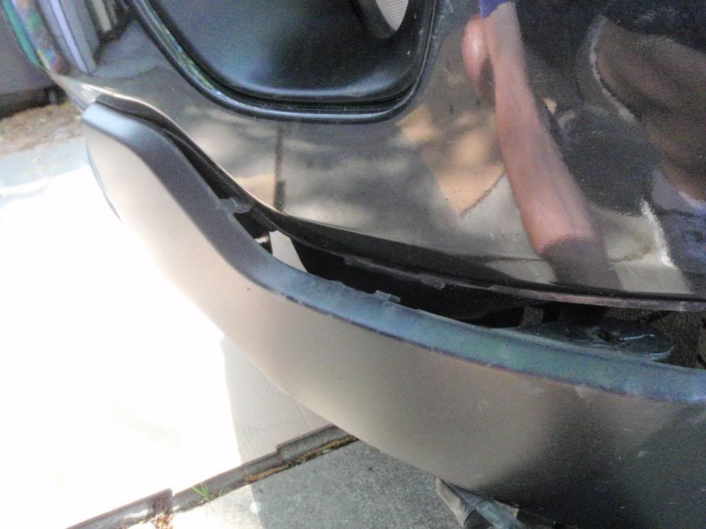

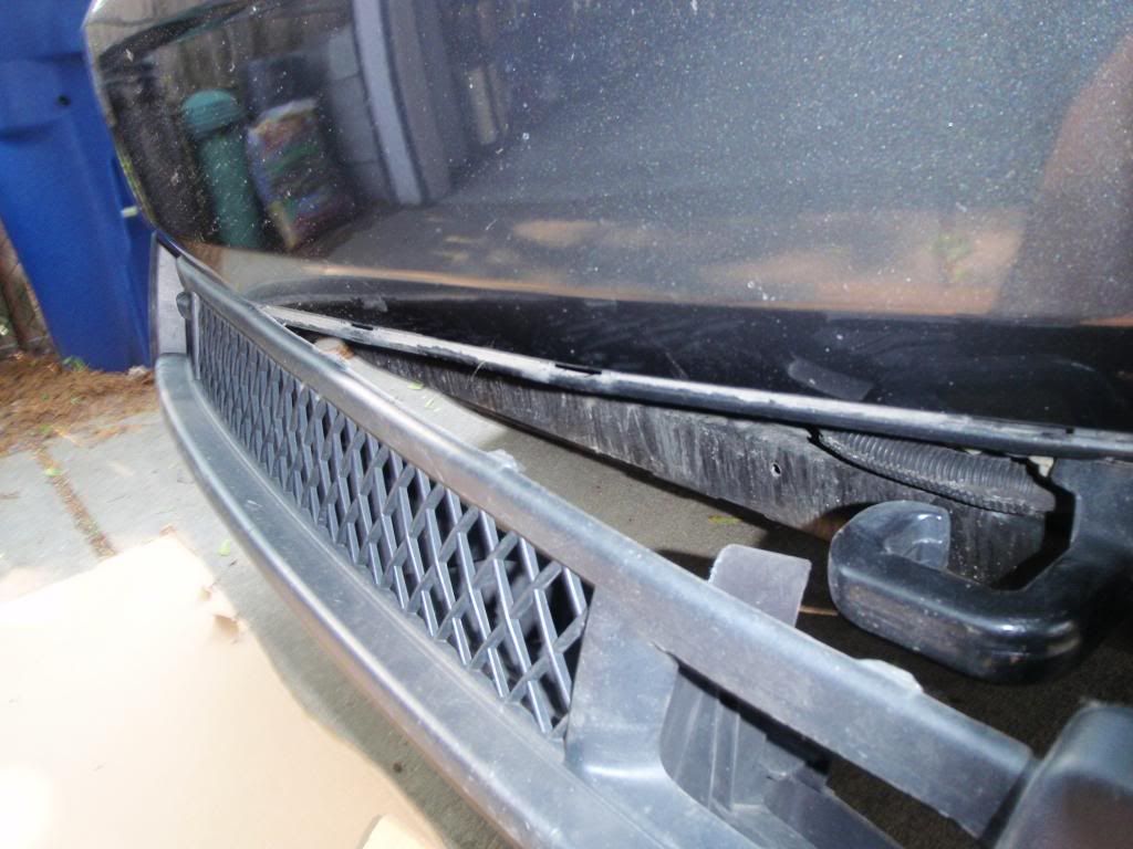

It is kind of hard to pull off, and I haven't put it back on but I wouldn't be scared of doing it. First unscrew the 5 caps (three on the bottom and two near the fog lights), then work from one side and pull forward. You may have to pull pretty hard so I wouldn't want to do it if it was very cold, it seems to me the plastic snaps may break.

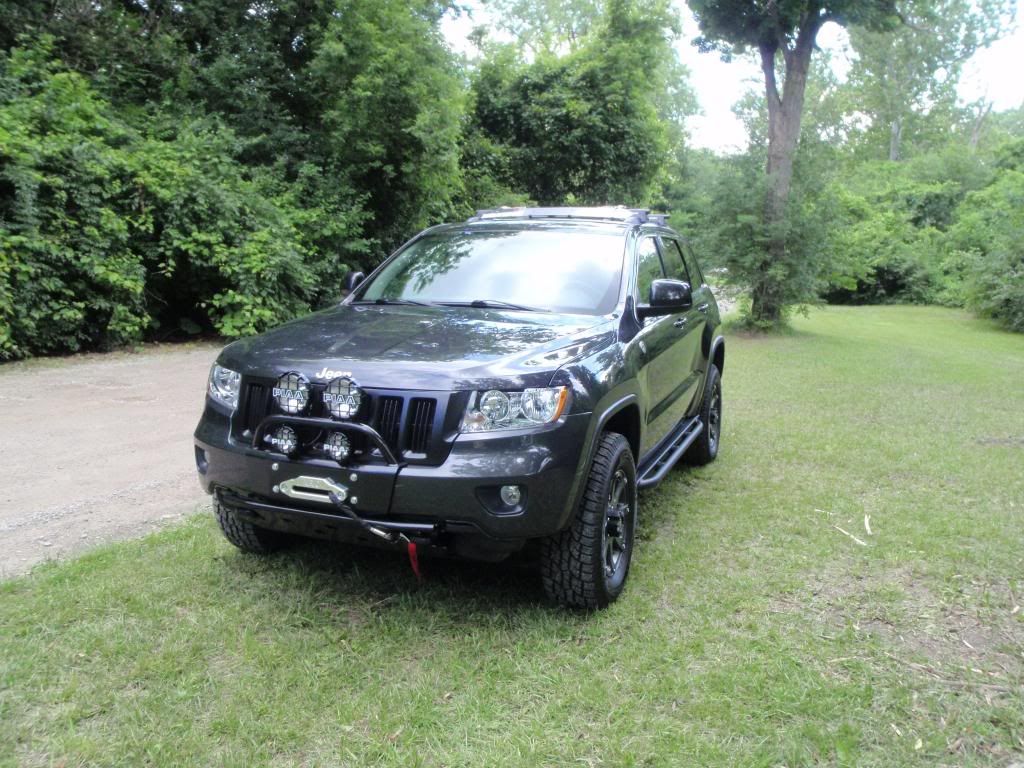

FINALLY got some time without a rainstorm to clean it up and snap a few pics with something other than a camera phone. I think I'm done modding for a while, heh, but I am going to do some touch up here & there.

The Jeep looks great.
