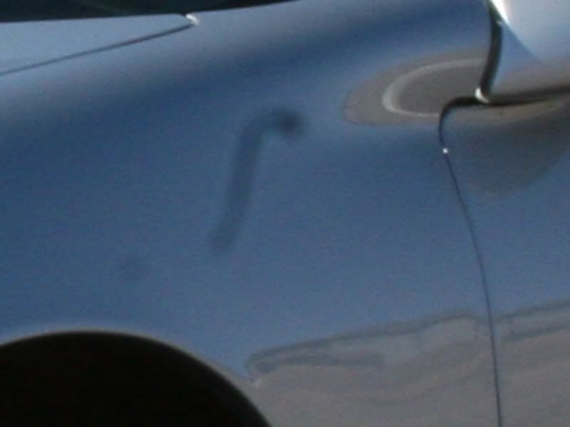

Alright guys, I'm shooting a Canon 30D. Couple different lenses, but regardless of the lens the same thing is going on which makes me believe its a sensor issue. The marking just in front of the driver's side mirror is in many of my shots. Always in the same spot, but the tone of that area does make a difference as to whether it is there or not in that image. Any ideas?

could you post a 100% crop of that area?

Here you go, the camera is about 2 years old and I take amazing care of it. I've run the system's sensor cleaning, and it seems to help some. However, after a while it appears to reappear until I run the cleaning again.

That looks like a piece of dust on the CCD. Set the shutter speed to Bulb. Once this is done, depress the shutter release, which pops the mirror up out of the way. Use a blower bulb to carefully blow air on the CCD. I do this about once a month for dust.
Nikon does not recommend this BTW. Just something I have always done.
