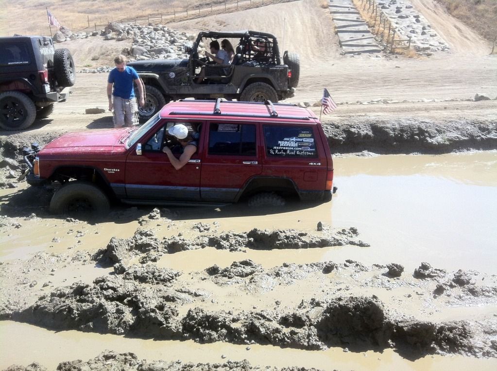

Would you use it for rappelling again after recovery? If so there's a Darwin Award in it for you. recovery straps are built for recovery. I carry four of them only because my fifth one broke when trying to recover this mess:
I would suggest a couple recovery straps and a snatch strap like the bubba rope. Getting home safely should always be above having a good time on everyone's checklist.
