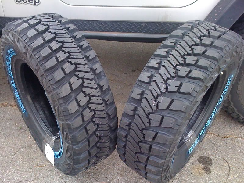

Here is a picture of an MTR and Duratrac tire.

See I'm used to seeing MTRs look more like this:
Anyways, tire size works like this. I'll use my stock tires for an example. 225/75 16. 225 is the width in mm, 75 is the sidewall. It's a percent of the width. So in my case, my sidewall is 75% the size of 225. And 16 is the rim size. If you said the last number was 18, then you have an 18 inch rim.
Most people go with 245/75 16 for tires, not too sure about exact rim sizes besides staying with the 16inch. Pretty sure our bolt pattern is 5x4.5 as well.

*First the tires are the original MTR tread pattern,
*there never was any other Duratrac tread design
*9 inch wheels are WAY too wide unless you only want to go straight
*for wheels stay with a 16 X7 inch wide with 4 inches of backspacing, this will sit the tire/wheel out a little over an inch from stock .
*Lift, why throw on a cheap junk lift when you want to do it right later on? Why waste the money?
*Tires stay with a 245-75-16 size, will fit good on the above wheels, no need to regear, no rubbing

I'd say the tire question has been answered. Rims? - the center caps aren't round; they have concaves to access the lugs so not sure they would be Cragars. My first guess was either Cragar or Unique - definately a "streetlock"/fake beadlock.
