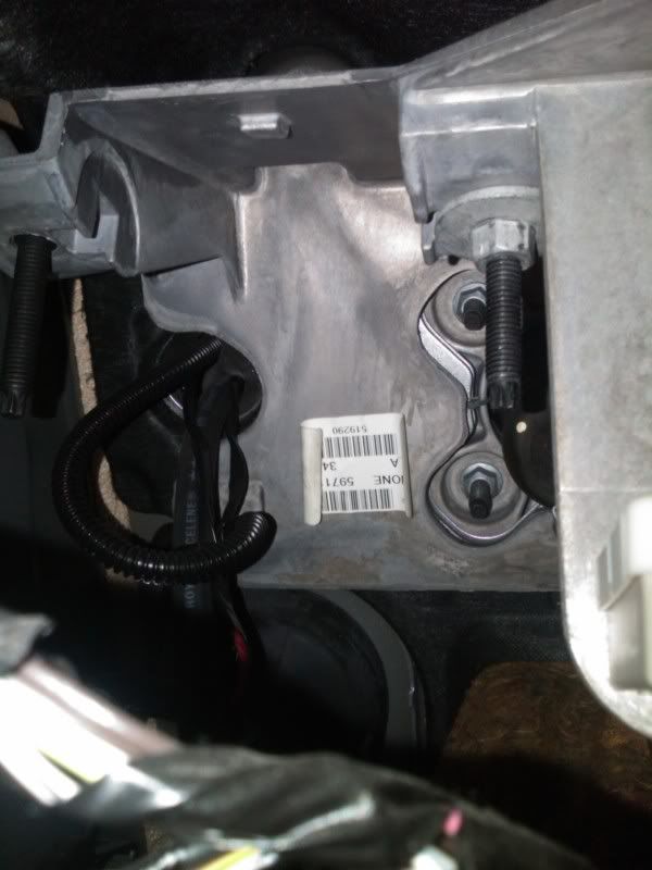

When I did my install in my 09 I found a rubber gasket/cap thing in the far right of the firewall when looking under the hood. I poked through and got my 0 gauge wire through and kept a water tight seal.
This is a pic from inside if you pull down the panel below the steering wheel, far left underneath.

thank you sooo much! the same, well at least another rubber gasket, is there! its slightly higher in the 08, but it's there!
