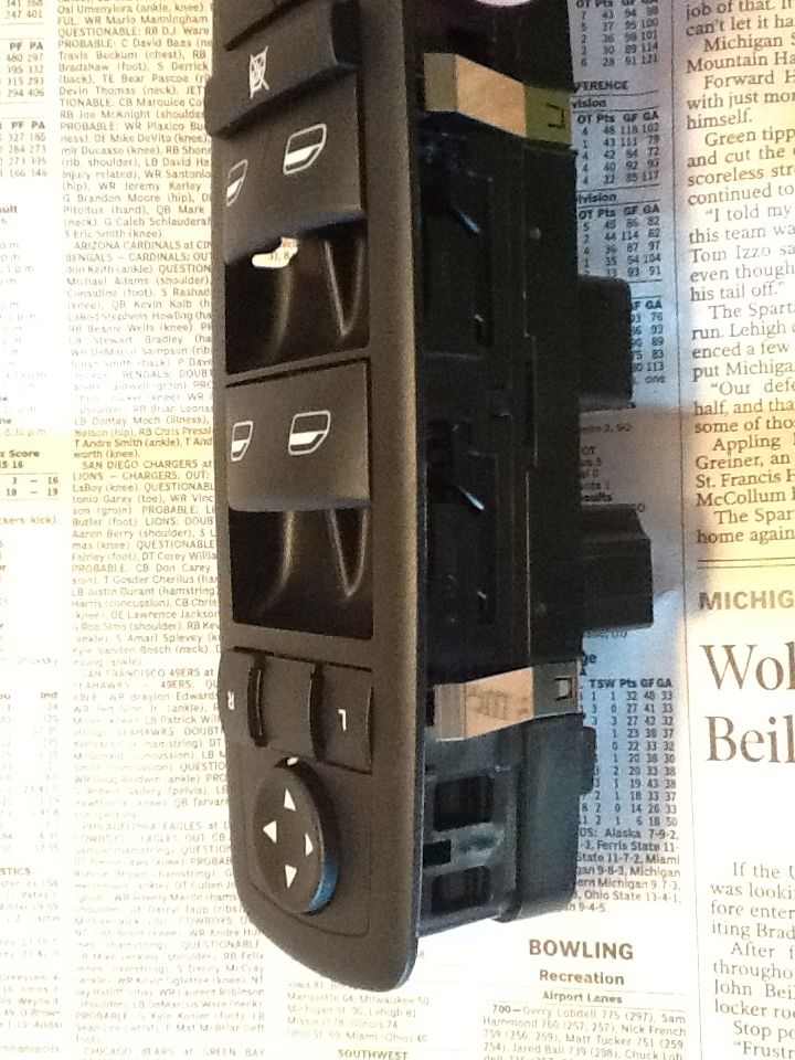

Originally Posted by bagwell View Post
might also try the panels with the window switches and doorlocks....mine was pretty loose, just kind of sitting in there.

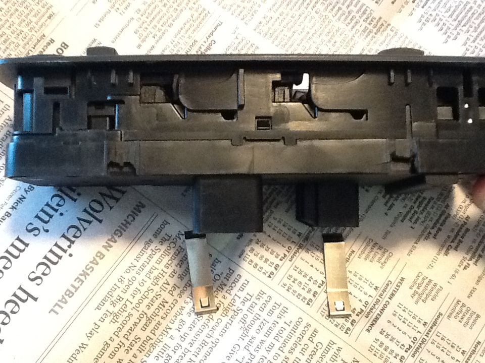

This was the culprit in my driver's door.
The plastic holding two of the metal clips was broken, so it was loose and rattled around in the armrest.
This worked well to glue it back together.
All fixed.

Thanks for the post! After you posted that, I checked out my door control panel and that was the culprit of mine as well! For the fix though, I just put stick on felt any place there might be contact and it seems to have done the trick. Now just to fix the other doors haha
