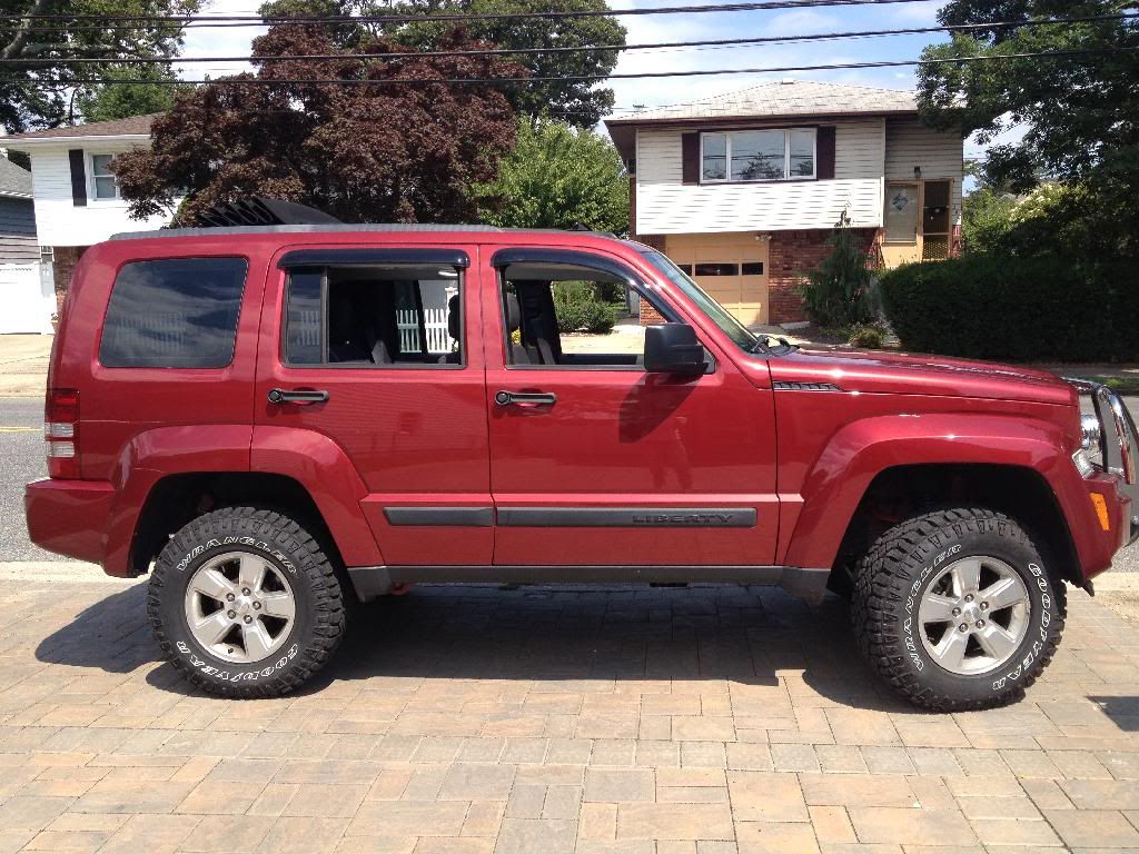

It's a 3/8 clevis right?(3 conduit nuts) If so then you WILL need a-arms, unless you choose to just to instal the springs and shocks(I still get spring contact at full droop. I might be able to clock my springs to get rid of it though). In the rear you only need 2 extra rear isolators per side(stock + 2 extra for 3 per side).
This will get you about 3-3.5" and sit level, or very slightly nose high.
This is right after install(with brand new springs and shocks) on 245/75-16s. Literally the week of install and alignment. My driveway isn't the most level down by the street.
This is a month or so later, as things started settling. It's by my girlfriend's house while sitting in the street by a drain.
