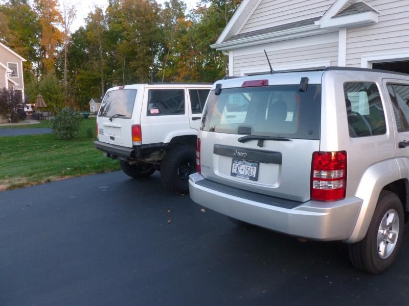

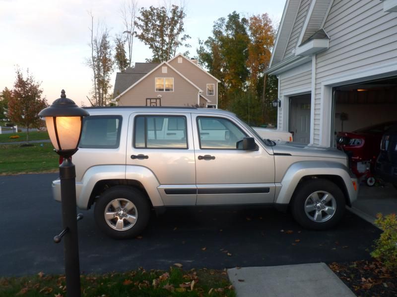

Plain Jane silver sport. I'm not a huge fan of silver, but it shows less dirt/road film. 16k on the clock. Spent last weekend undercoating it with a combination of Eastwood's heavy duty anti-rust and fluid film. I'm going to make this thing last. Found painted over staples in the fender flares and freaked out a bit thinking it had been in an accident (carfax was very clean). After doing some research it turns out the staples are there to put a charge on the plastic part for electrostatic painting. Most jeeps with painted flares have them. Weird.
It's hard to compare the KK to the XJ. For one the XJ is built and the KK is stock. I find the KK suspension way too soft. The *** twerks like crazy over RR tracks. The engine is adequate. I hope the KK will grow on me, but I'm having a hard time switching over from my beloved XJ. I'm sure my snotty neighbors will be happy to see the cherokee go I will be putting a new suspension on the KK next summer. I'm either going with OME or Tommudd econo. They both probably ride well, but I'm wondering if I'll need new UCAs with the OME or not. If I need them regardless for alignment then I might as well get the Tommudd lift.
Here a shot of the two. Notice the roof lines are at the same height even though the XJ is lifted ~6" and on 33" duratracks.
2012 KK Sport (Silver). Bone stock.
