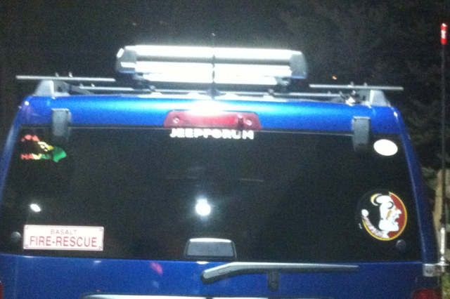

and like i mentioned, you dont have to drill at all if you dont want to. Below is a picture of my rig with two different antennas installed. One screwed in using the firestik (CB) and another antenna for VHF/UHF that is magnetic. Wiring is the same except the wire comes out of the vent and up and out of the gap between the liftgate and the roof. You can see the magnetic antenna on the right side, the little silver thing. Wish i had a better picture.
Plus someone on here once said "A jeep isn't truly yours until you put your first hole in it!"

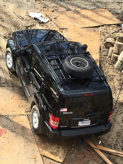

I know that this is an older post but having issues with tuning my cb with this exact setup. I am holding steady at 2.8 swr on both channel 1 and 40, i had both the quick disconnect and the heavy duty spring and swr were above 3 with both then down to 3 when removed the disconnect. does painting the mount cause any issues with this?
fireandrainksm is offline
post #104 of 104 Old 06-10-2016, 06:55 PM Thread Starter
GoodPrepper
Location: Columbus
Posts: 81
My mount is painted and I was able to tune 1-40 down to about 2.2:1 in the middle and still under 3:1 at the ends. The strange thing I noticed was that I would tune it to where I wanted, put the red cap back on the antenna and then get a final reading and find it was off. I have no idea why a plastic cap would effect the antenna (I had the tip cranked down tight so I don't think that was moving it).
Man, I haven't been back to this post in a while, I'm so glad it helped some folks. I am still running this set up and it is going strong! This old battle wagon is 6 years old with 95,000 miles and I've been thankful to have her as I build a cabin up on top of a hill in the middle of the woods and the driveway wasn't always the most accessible thing in the world.
